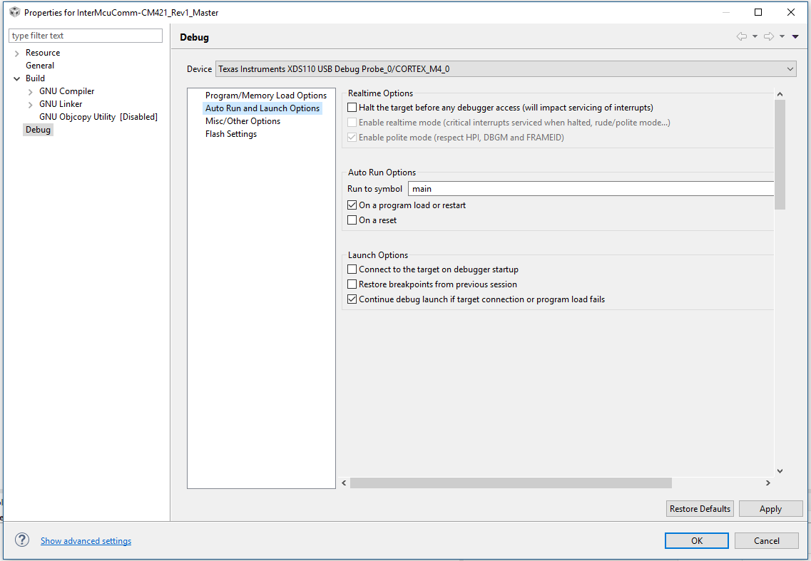

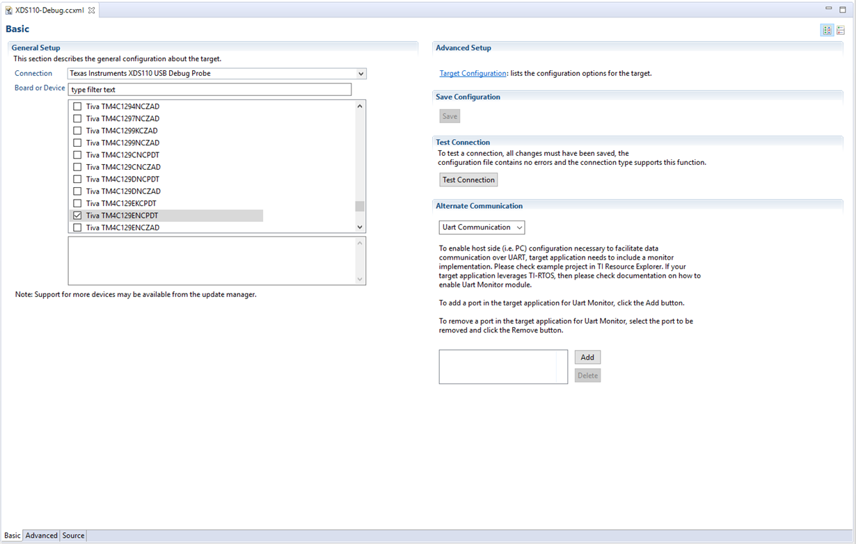

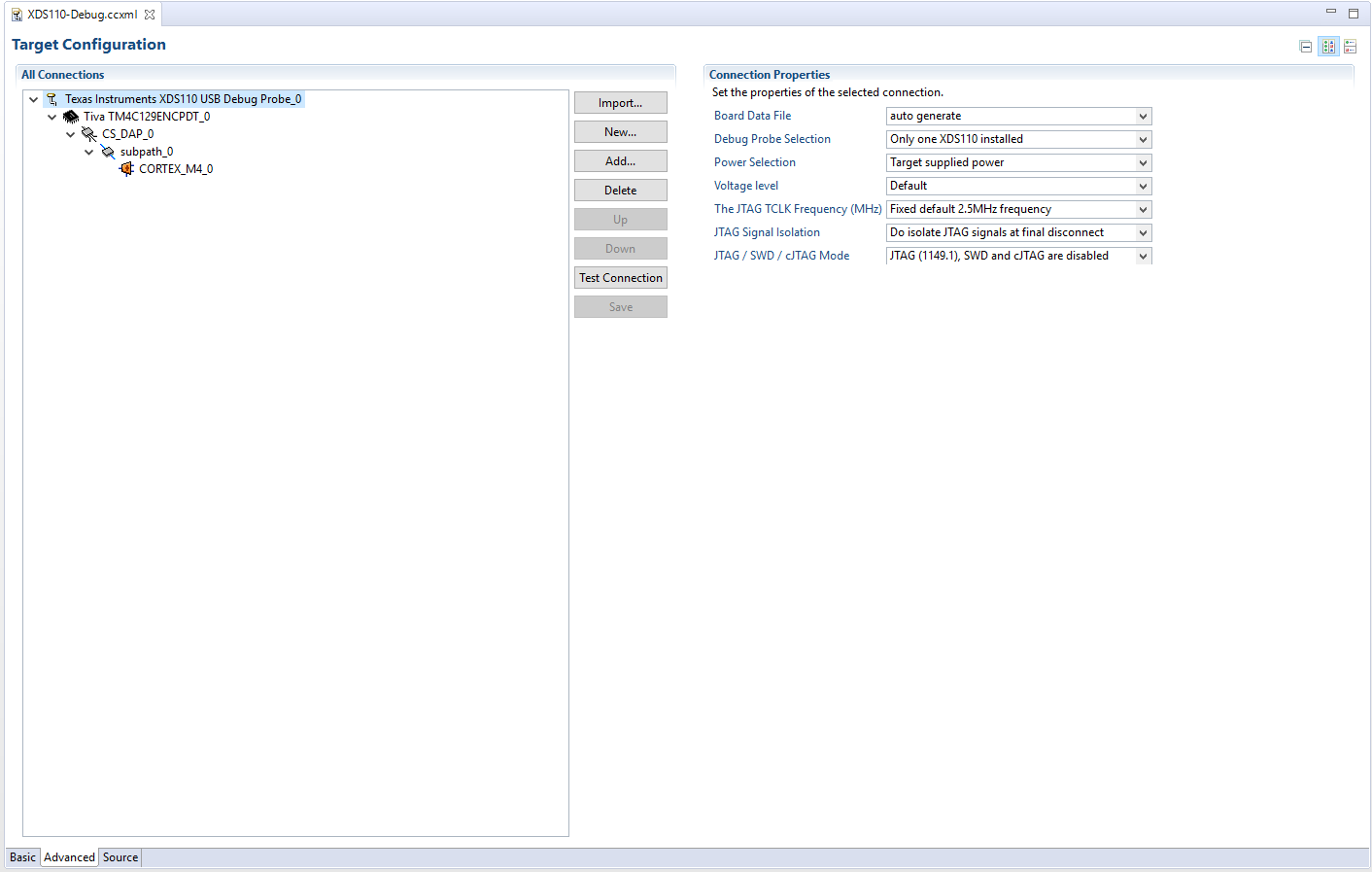

Single-stepping in the debugger is painfully slow with our XDS110. Each single-step takes from one second to several seconds.
In contrast, when we use the ICDI of a EK-TM4C123GXL to debug our board, it feels very snappy and quick. Each single-step takes a fraction of a second.
Being so slow, the XDS110 is hardly useful for debugging. Perhaps we need to configure it differently?

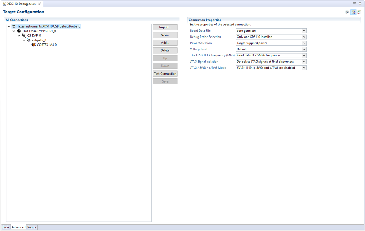

Currently our target configuration is as follows:
Debug Probe Selection: Only one XDS110 installed
Power Selection: Target supplied power
Voltage level: Default
The JTAG TCLK Frequency (MHz): Fixed default 2.5MHz frequency
JTAG Signal Isolation: Do isolate JTAG signals at final disconnect
JTAG / SWD / cJTAG Mode: We tried two different settings: "JTAG (1149.1), SWD and cJTAG are disabled" and "SWD Mode - Aux COM port is target TDO pin."

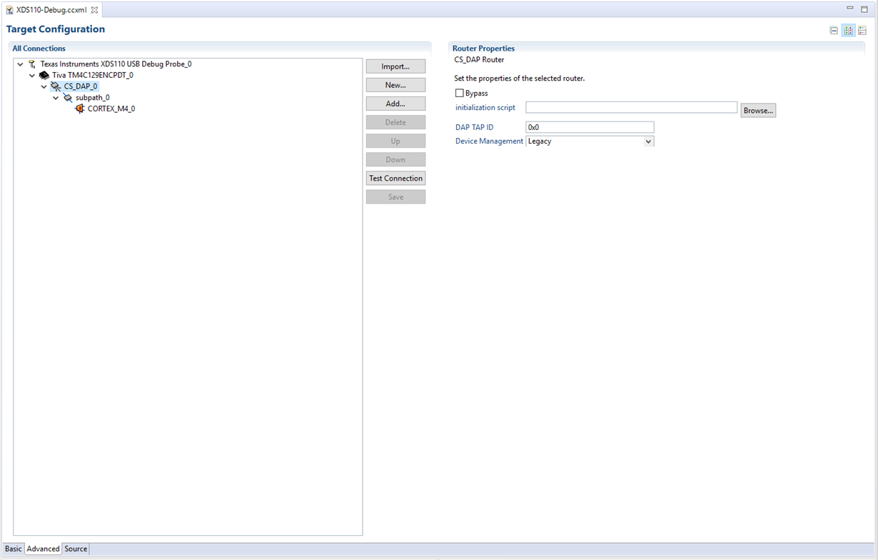

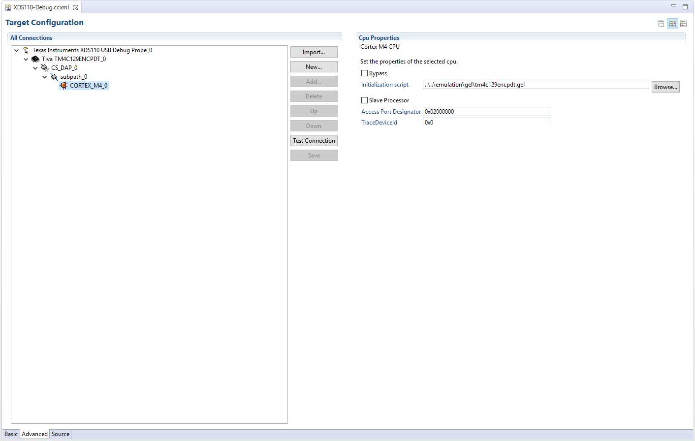

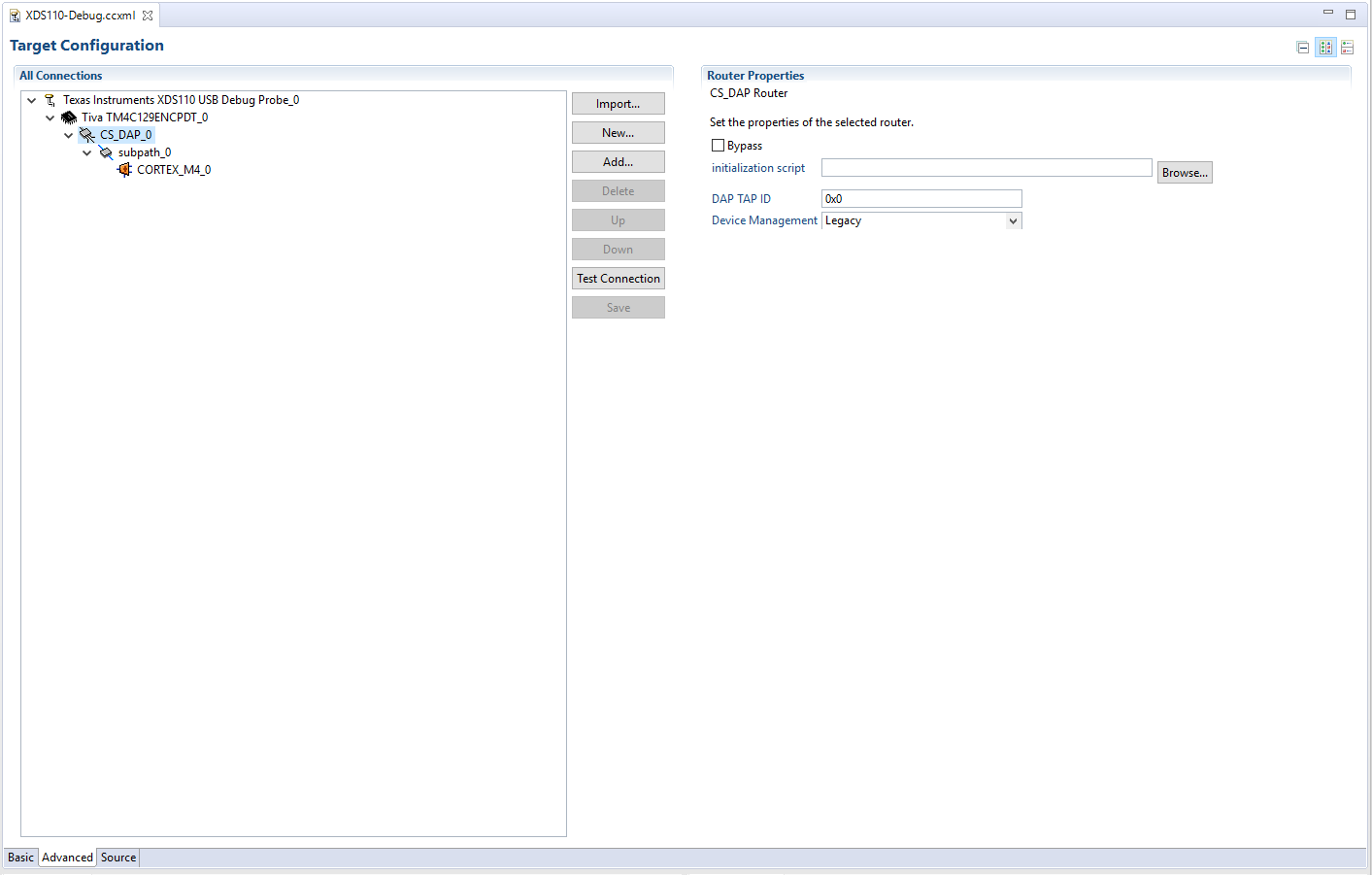

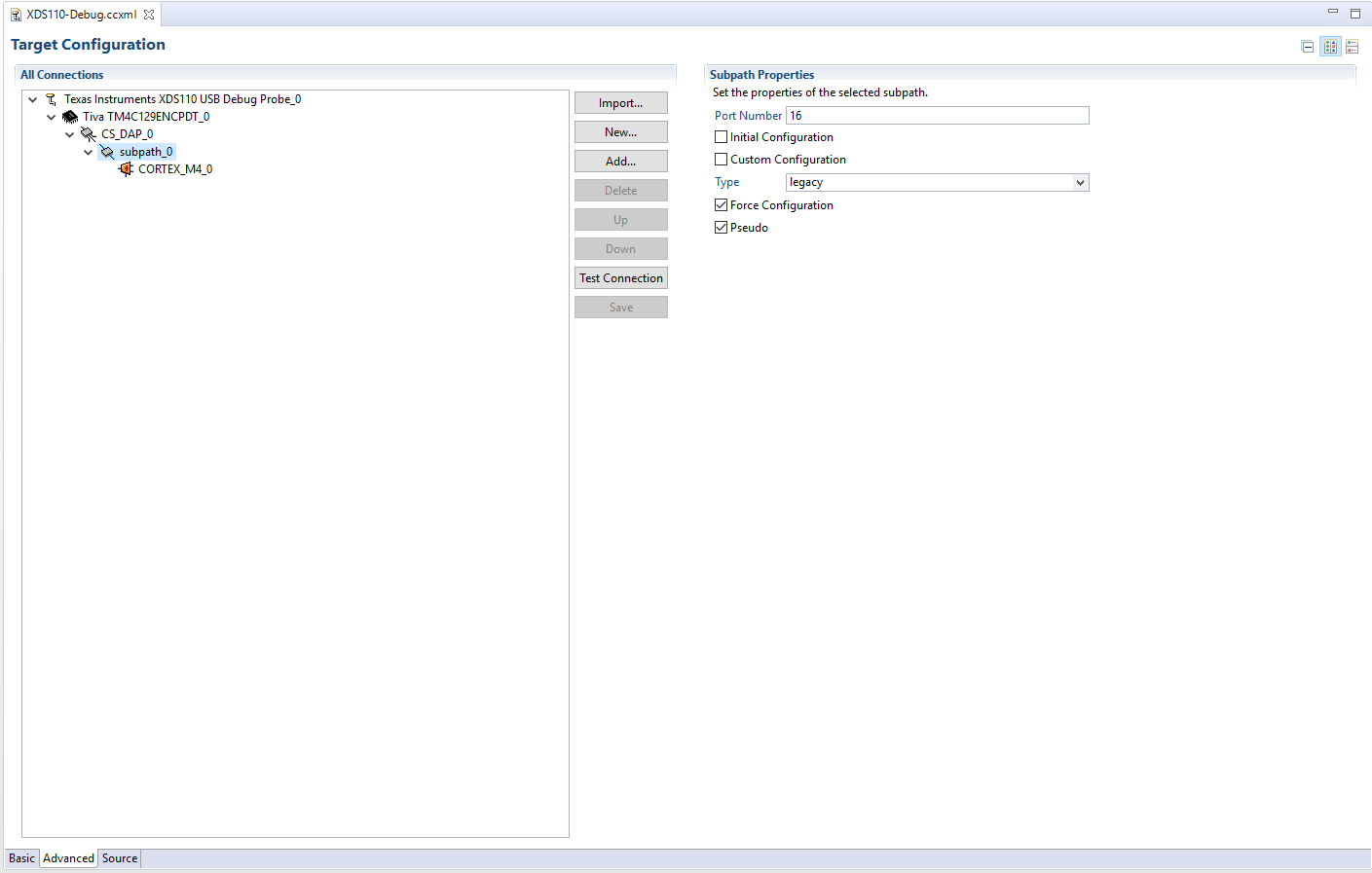

Subpath 0 properties:
Port Number: 16
Initial Configuration: NOT checked
Custom Configuration: NOT checked
Type: legacy
Force Configuration: Checked
Pseudo: Checked
Cpu Properties (Cortex M4 CPU)
Bypass: NOT checked
Initialization script: "..\..\emulation\gel\tm4c129encpdt.gel"
Access Port Designator: 0x02000000
TraceDeviceId: 0x0

  • Should we modify any of our settings that I listed above?
    What else in our setup should we check? E.g., in CCS, in Windows, in our hardware or software?

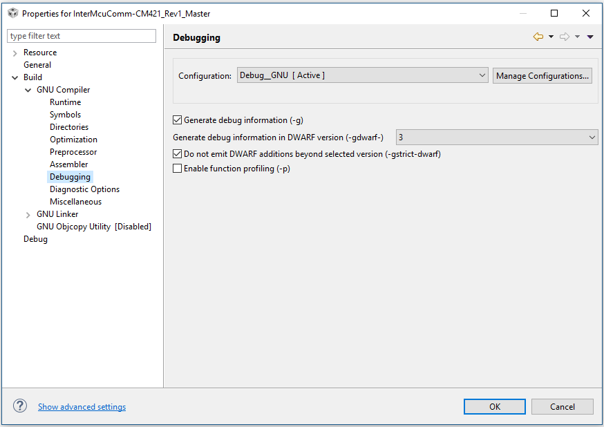

    Since you mentioned before that you were using CCS version 7.4.0, and we were using version 7.2.0, we went ahead and upgraded our installation to 7.4.0. In the meantime, Windows installed some updates as well.
    We then loaded our program to our TM4C129ENCPDT and single-stepped over a section of code using ICDI (using a modified EK-TM4C123GXL board). We then loaded the same program to the same part and single-stepped over the same section of code using the XDS110 debug probe. My colleagues agree that there is an obvious, significant difference in the speed of single-stepping. Whereas the ICDI interface is working properly and each single-step takes a very short fraction of a second, the XDS110 is taking over one second and in some cases clearly takes several seconds to make a single-step. This is the same outcome as with the earlier CCS version.
    We looked over your XDS Performance Comparison wiki page and it is clear that XDS110 performance is supposed to be quite good.
    There must be something about our configuration that is causing these issues but we have been unable to identify what it might be.

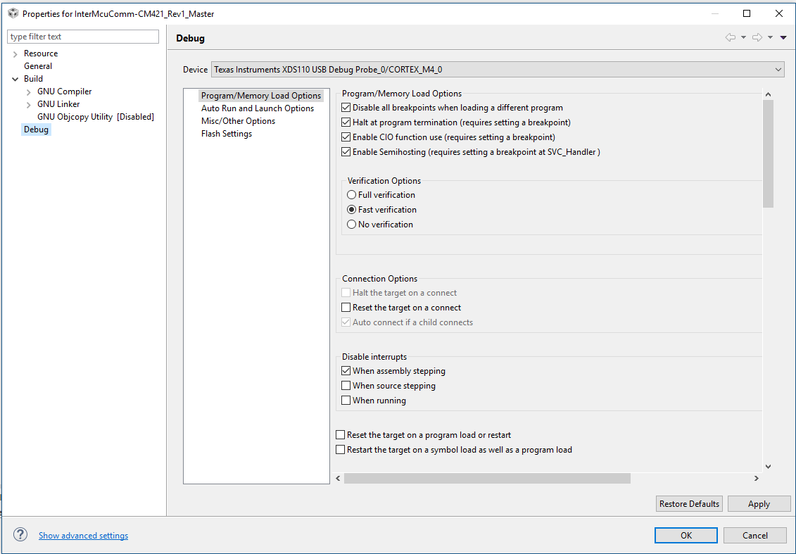

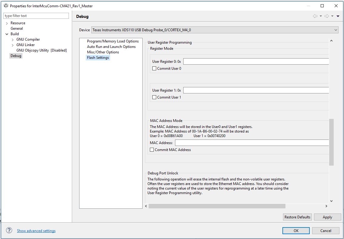

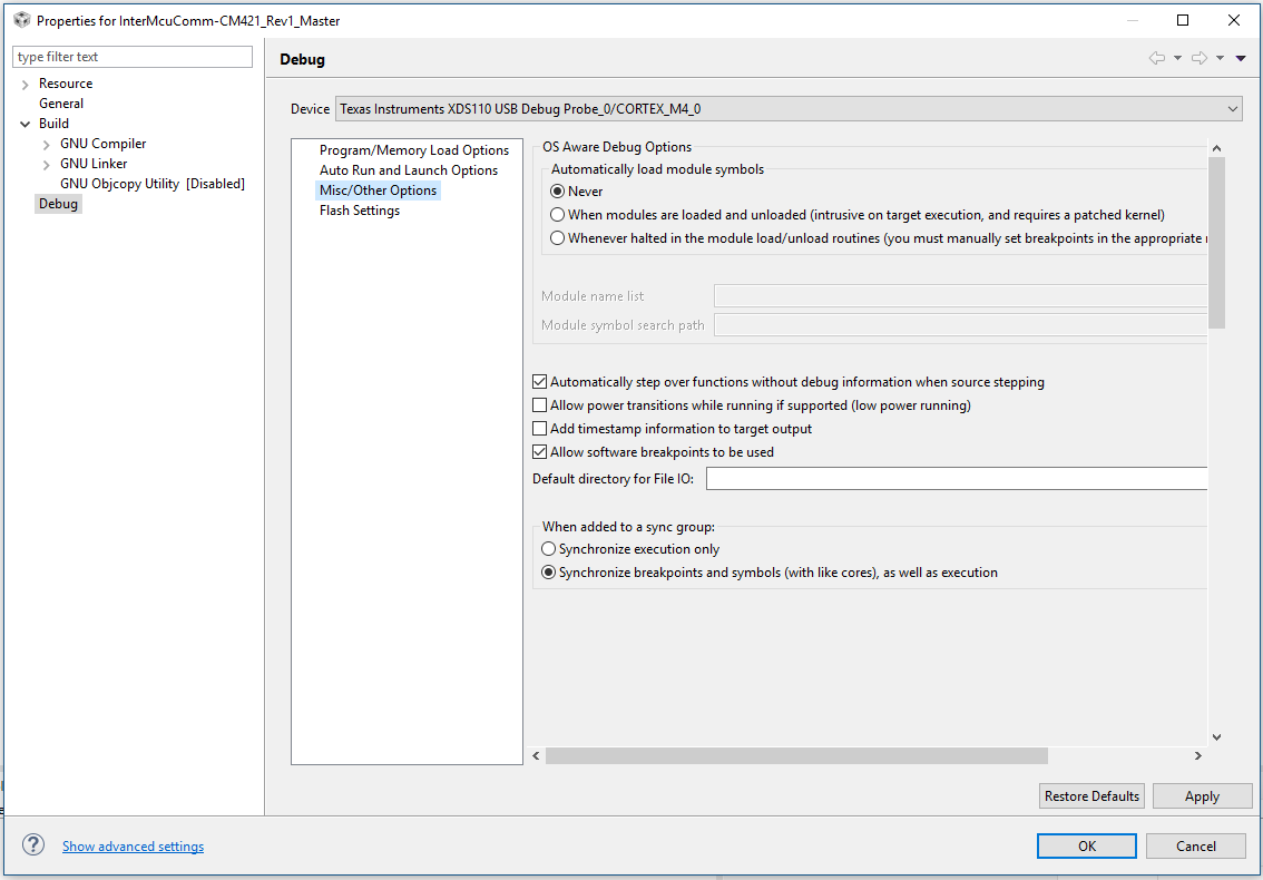

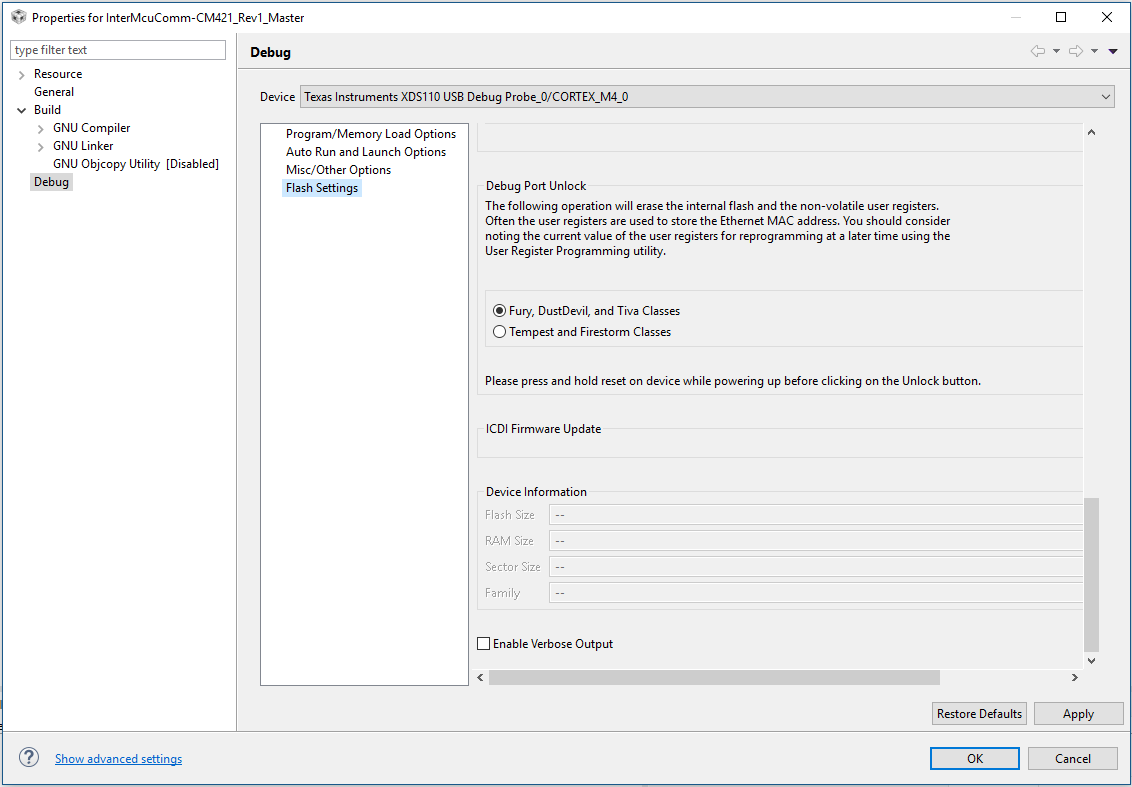

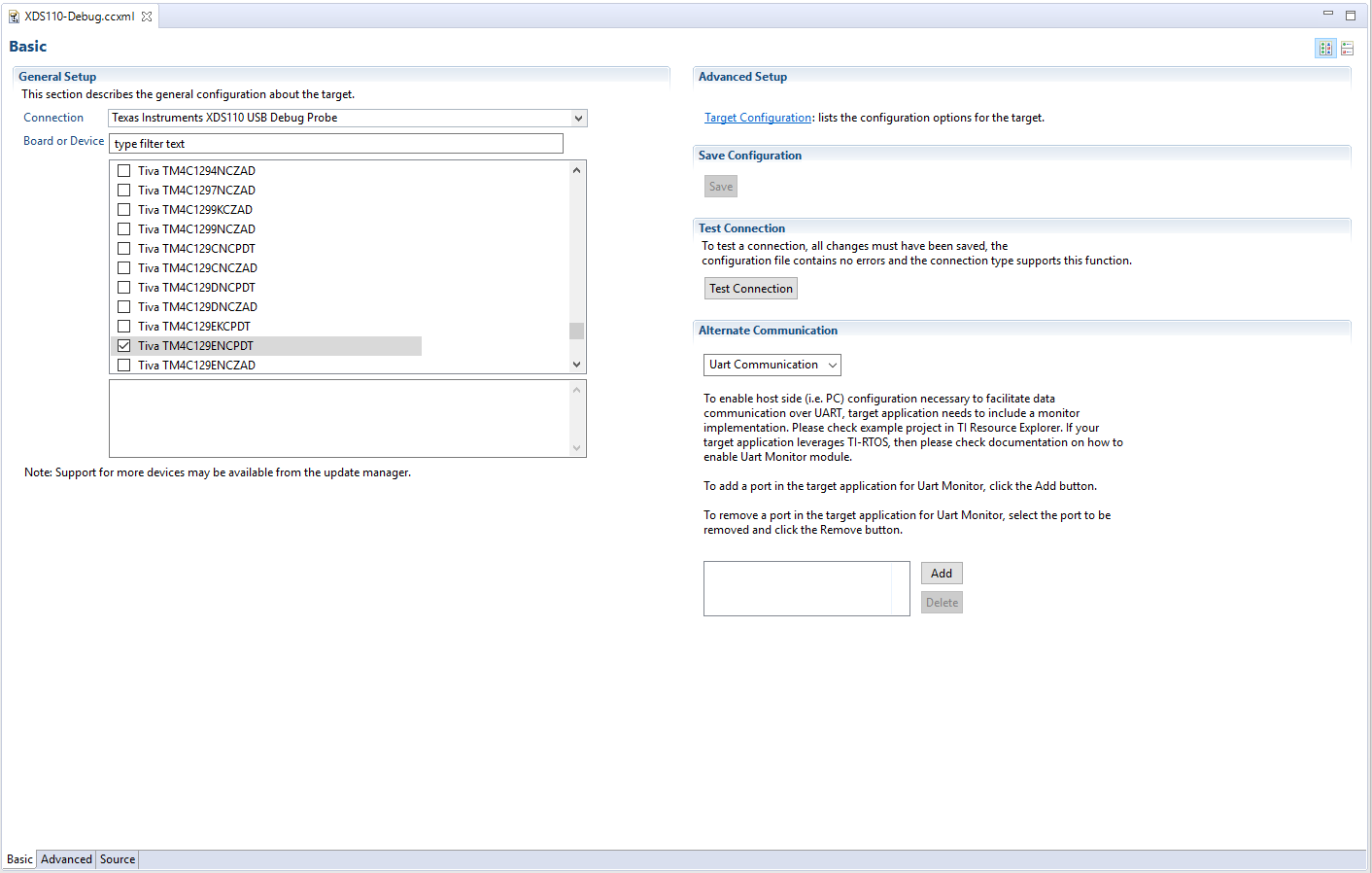

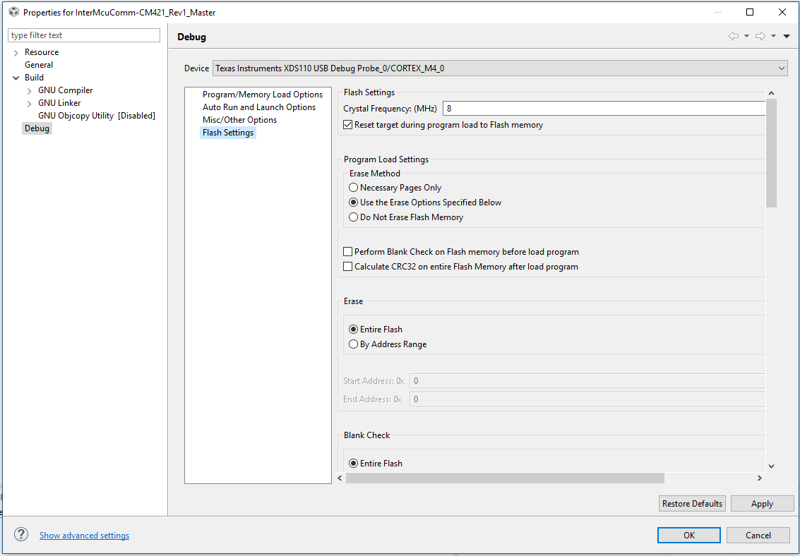

    I will include screenshots of our setup:
