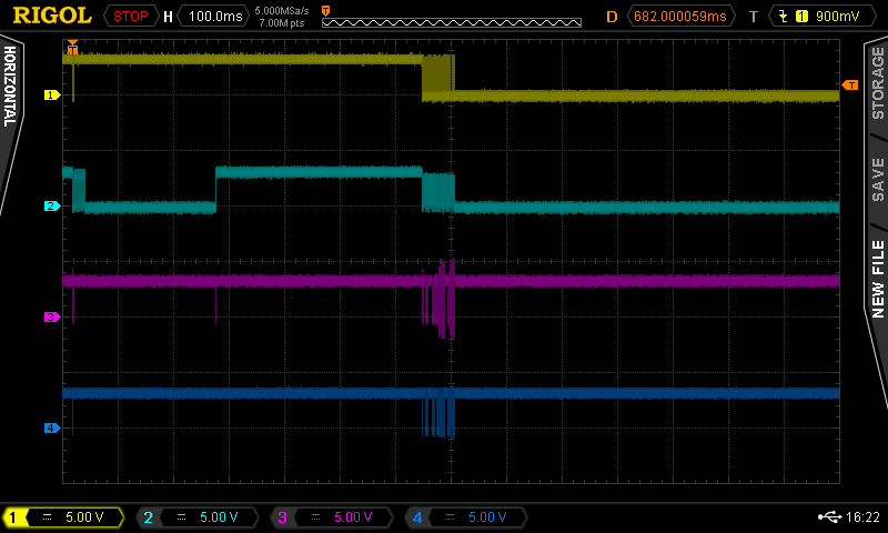

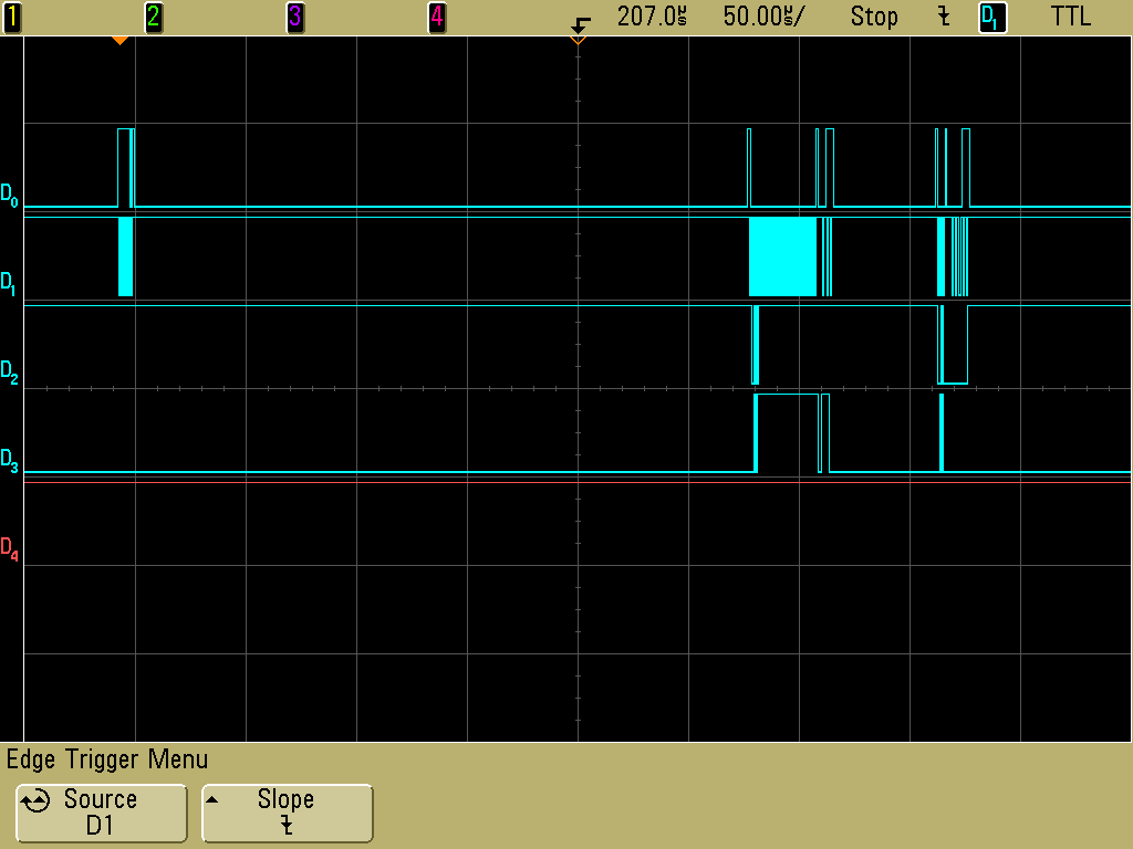

  • I also just tried slowing down the clock to 100khz, and it did not help.  The Segger programmer is set for 1.2Mhz clock and works fine.
    I also have attached screen grabs of my scope on all the programming lines:
    D0=TMS
    D1=TCK
    D1=TDI
    D1=TDO
    D4=RESET
    This is the XDS starting the Test Connection via the Target Config Menu
    Here is the Segger starting programming:

  • Chris,
    Please apologize for the delay; Ki is out in vacation and I ended up not being able to get to this thread.
    Looking at the screenshot for Segger it seems the transmission is being triggered on the rising edge of TMS, which is odd.
    I would be suspicious that your device was in SWD mode and it was confusing the XDS100v2, but from your capture all four lines are being activated, thus ruling this out.
    At this point I can't necessarily know what may be happening in your case. If you can extract the part of the schematics that connects the JTAG connector to the device (including all PUs and PDs) that would be helpful. You can also compare with the section "Single Device Non-buffered Configuration" of the Target Connection Guide that Ki sent before, which is what I would do as well.
    I send at the end of this post a capture of a successful "Test Connection" that I did a few years ago for comparison (done on a F28x device using a XDS100v1 at 1MHz).  Perhaps it helps to shine a light on the data captures you are getting.
    Another idea is to use an oscilloscope instead of a Logic Analyzer - who knows? Maybe there is noise happening on the line that is not being picked by the LA.

    This is a capture of the entire "Test Connection" phase on my F28335 Experimenter's Kit (XDS100v1). I am triggering on the first falling edge of TMS, which usually corresponds to the first transaction on the JTAG flow (check this reference). You can notice how the initial transaction happens at about 20ms and the actual data transfer (the tests that are failing in your case) are in the middle of the screen - around 0.6~0.7s after.
    CH1: TMS  CH2: TCK, CH3:TDO, CH4:TDI
    This is a zoom into the initial transaction phase (200us/div). Notice the trigger at the falling edge of the TMS.
    These are two zoomed images into the final data transfer phase (5ms/div and 2ms/div).
    5ms/div - the entire data transfer test
    2ms/div - a zoom into the initial phase of the data transfer test
