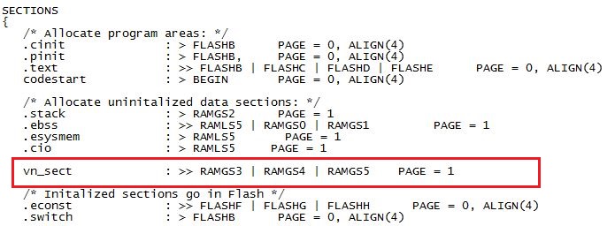

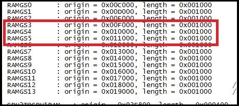

    Then I changed the linker file as follows
    But I am Getting insufficient memory error
    As per that error space needed is 0x1929 so essentially RAMGS3 and RAMGS4 should be enough . Right???
    Please Help

  • Hi
    I have got it to compile without error by changing following things in the linker file.
    Increased the size of RAMGS3 from 0x01000 to 0x02000. and allocated RAMGS3 to "vn_sect"  as "vn_sect :> RAMGS3   PAGE = 1"
    This is a reasonable solution.  Your original problem is that the input section vn_sect was larger than any of the memory ranges you attempted to allocate it to.  Section splitting (signaled by the >> syntax) can only split an output section on input section boundaries.  This is discussed in the section splitting part of the Linker Primer article I referenced earlier.  You solved it by collapsing a few adjacent memory ranges into a single memory range, which is then large enough to hold vn_sect.
