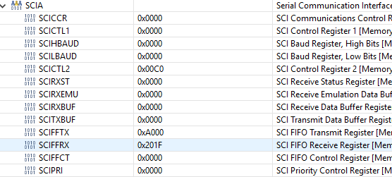

I'm using the demo code from controlsuite serial internal loopback C:\ti\originControlSUITE\device_support\f28m35x\v220\F28M35x_examples_Dual\Internal_Loopback_Serial
1. Could you please let me know how did we verify this demo works well?
I can see RX, TX buffer sometimes both become 1, but it didn't constantly flash to highlight on those register, does it looks right to you?
The trouble I'm having is that I look at SCI register on C28, sometime it's setup all right in the following figure 1; however, sometimes it's not like figure 2
2. Should I manually enable the IPCMtoCBootControlSystem() code ? Because by default, it's grey out and looks like disabled while running.

  • Yinghui,
    It looks like the code is working. CCS highlights changed registers only when they change. If the same value is written to the register it will not highlight again (that is, it must be a changed value). If you would like, you could modify the code to have the value increment and then you will see the register in CCS highlight. Alternately, you can modify the code to slowly blink an LED, or run the code in real-time mode and manually change the value.
    The reason you are seeing the greyed out line is because this is a conditional build, where either the code line for RAM or Flash will be used, but not both. A good resource to learn more about the device and the procedure for dual-core debugging can be found in the F28M35x workshop:

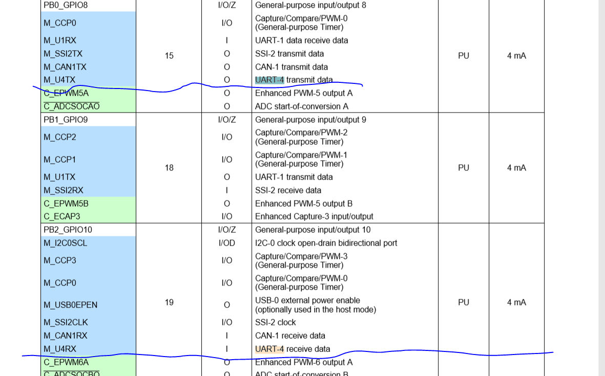

    I'm using ConcertoM3 Evaluation board, do we know where can we probe for UART4 of M3 ? I still need to add the serial protocol on this internal communication, so I'd like to find out how can I put Logical analyzer on TX, RX on UART4?

  • Yinghui,
    You need to refer to the F28M35x data sheet to find the pins associated with UART4. The data sheet can be found at:
    http://www.ti.com/lit/sprs742

  • Hi Ken,
    The data sheet assign the UART4-TX on GPIO8, however, we configure this GPIO for other purpose. Since UART4 and SCI-A are internally connected, if we probe on the SCI-RX, does that mean it'll will be the same as we probe on the UART4-TX ? Please correct if I'm wrong.
    Yinghui
  • Yinghui,
    They are not internally connected, but multiplexed. See the Technical Reference Manual:
    http://www.ti.com/lit/spruh22
    Starting on page 337 and see figure on 342.
