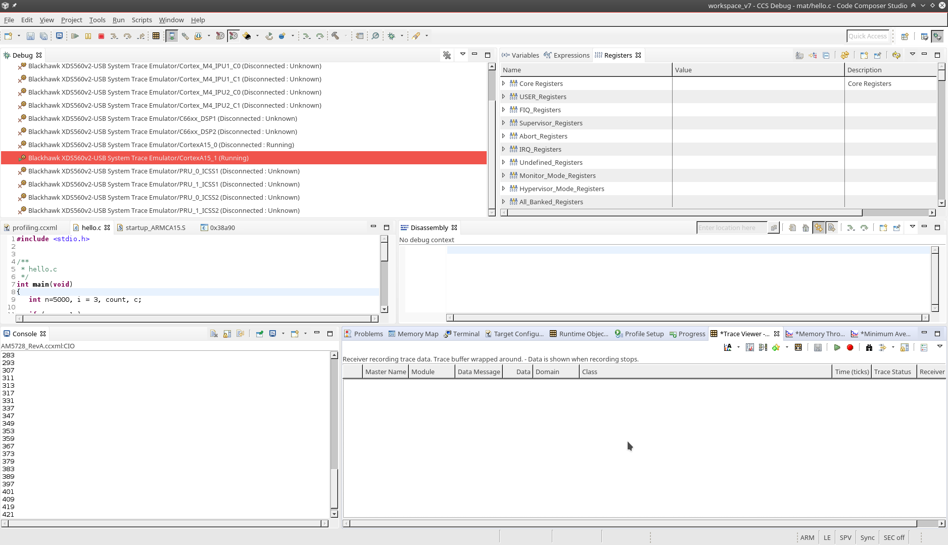

I am debugging a prime number generator program on bare metal on AM752x EVM board. I am using Blackhawk XDS 560v2 for the same.
1) It uses on board ETB. But even for small programs, the trace buffer wraps around. That means, I cannot collect any meaningful data for the entire run of the application. Is there anyway to extract the ETB data before it wraps around? I understand that I could use the pro trace. But, it is so expensive for me.

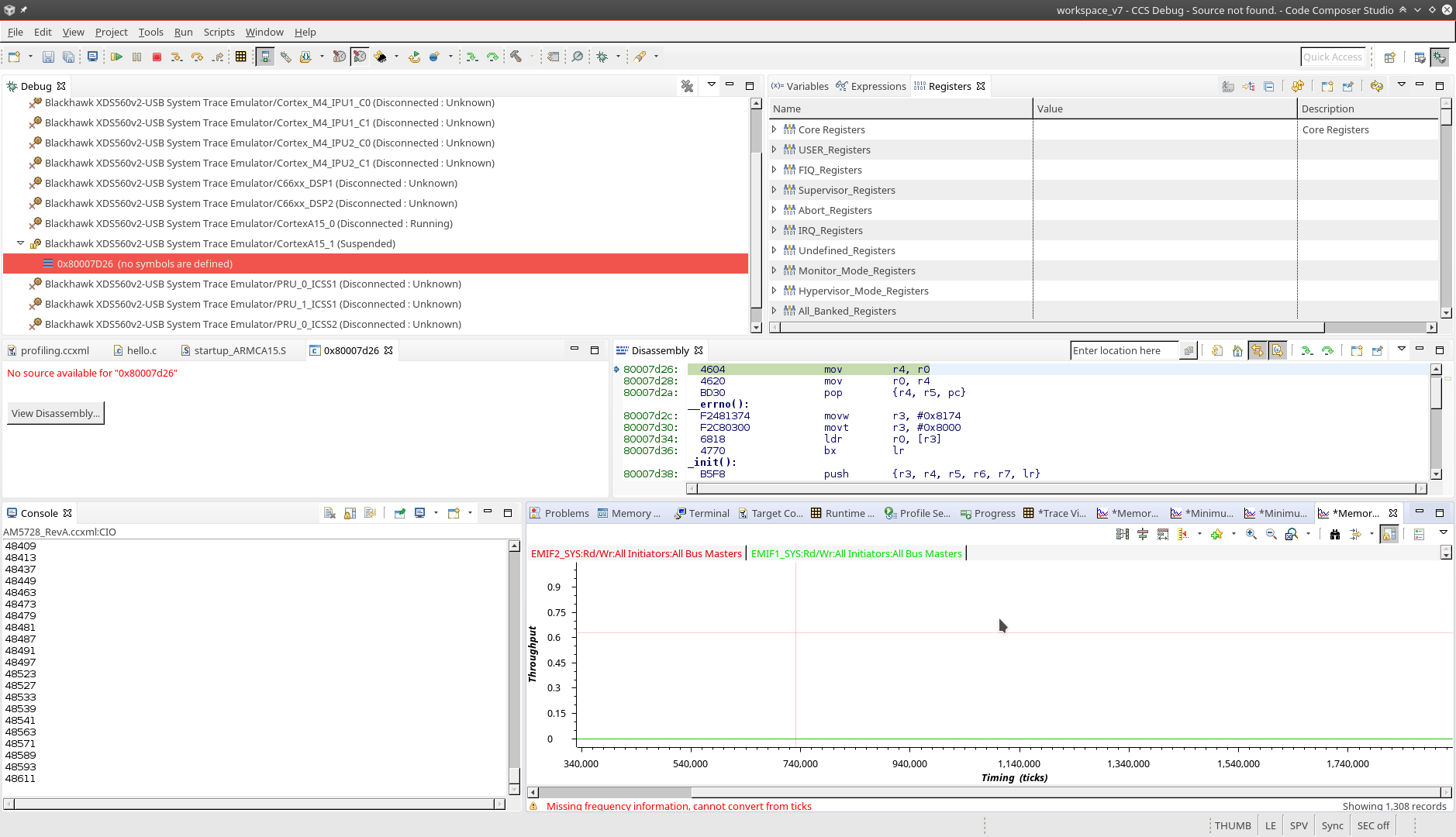

2) When, I am trying to run memory throughput analysis, I am getting "Missing frequency information, cannot convert from ticks" warning. See picture attached. It is only shown very briefly and then vanishes. Nothing relevant is shown. What  could be wrong with that?

    1) Unfortunately ETB is quite small and is exhausted quite quickly on a 1GHz part. Certain architectures allow halting the core when ETB is filled, but I don't think this is supported on Cortex A, but I couldn't find any reference that confirms that. I will have to double check this.
    2) The Debugger GUI does not have knowledge about the clock speed of the device and ETB does not carry timestamp information, therefore this message is displayed. ProTrace allows gathering more precise timestamps due to the additional bandwidth.
    The lack of data is most probably due to the fact you are either running your code entirely from the internal RAM or there is no data transfers between the internal RAM or a peripheral (DMA, for example) and the EMIF. The measurable throughput is then zero.

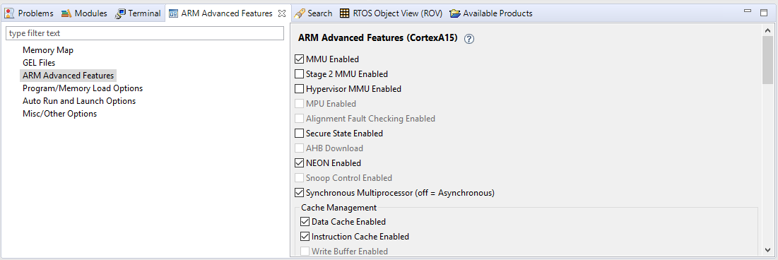

  • solid repellent said:
    How do I check if the cache is enabled?
    The CCS Tools -> ARM Advanced Features view shows if the Data Cache and Instruction Cache are enabled. E.g. for a SYS/BIOS program for a Cortex-A15 core of an AM5728 which has enabled the cache:
    I mean where do I enable it?
    The I (Instruction cache enable) and C (Cache enable) bits in the Cortex-A15 SCTLR System Control Register are used to enable the caches. In order to get the performance improvement of data being placed in the cache requires the MMU to be enabled to define cacheable memory areas. If you are writing a bare metal program, PROCESSOR-SDK-RTOS-AM57X contains CSL functions for enabling the MMU and cache. See ti-processor-sdk-rtos-am57xx-evm-04.00.00.04\pdk_am57xx_1_0_7\packages\ti\csl\example\mmu\a15_data_validation\mmu_a15_data_validation_app_main.c for an example.
