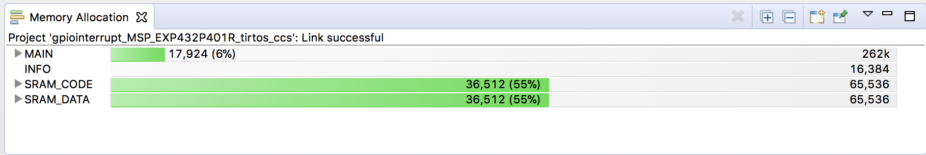

The View-> Memory Browser just stopped working. It used to But now I get a blank page. Do I have to do something else to get this to tell me how much memory is being used?

Can you attach a screen shot with both the memory browser and the debug view.
View -> Memory Browser is used to inspect the contents of memory.
If you are looking to see how much memory is being used you can try View -> Memory Allocation View.
There is also the map file that can be inspected:
