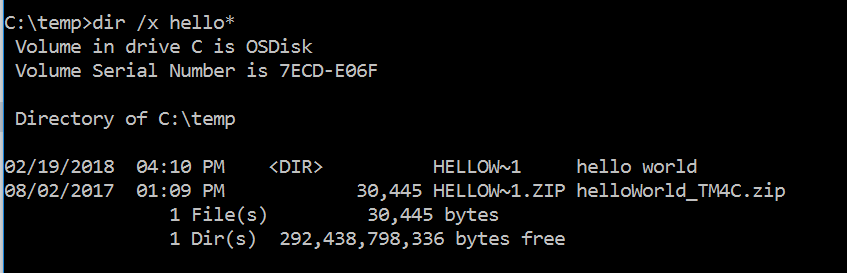

Sorry to hear that.
Before suggesting the recipe I've tried that on Windows machine and that seemed to work at least with space containing project folder. We gained knowledge that does not help on Unix like OS.
