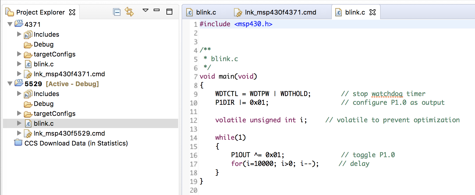

    One possibility is to use tab groups.  In this capture I have created 2 tab groups for the editor and then I have placed the files for different projects in different groups.
    There are some limitations with this:
    1. You have to manually organize the file tabs into the appropriate group.
    2. It is not overly scalable as if you had more than 2 or 3 groups you will use up all of your screen.
    Another option is to close projects.  You can open and close projects from the Project Explorer.  When you close a project it will close the windows for the associated source files.
    A more extreme option would be to open multiple top level windows in CCS.  You can do this from the Window menu by selecting "New Window".
    Another thing to note is that there is some linkage between the editor and the Project Explorer.
    Here I have clicked on the one blinky.c file in the editor and the associated project is marked as active.
    Then I select the tab for the other one and you can see that the other project is now active.
    I realize that none of these were exactly what you were looking for but hopefully they are of some use.
