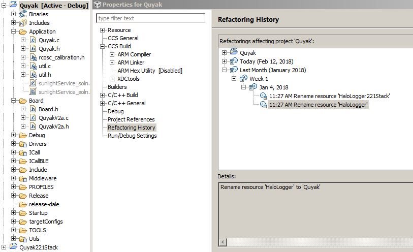

I renamed my project name and a referenced file name over a month ago and have been happily building in debug configuration ever since.
Here is the refactoring (2nd change was from HaloLogger221Stack to Quyak221Stack):
Today, I tried for the first time since then, to build in the release configuration and have had no luck.
So far have tracked it down to the fact that it does not look like my renaming I did a month ago made it into the release configuration.

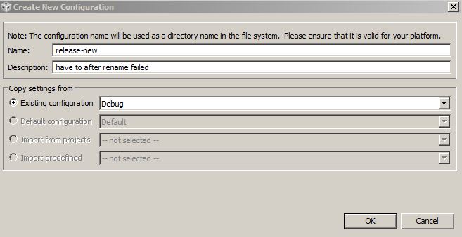

I have tried:
1. 'Edit Flags' but I cannot edit the incorrect HaloLogger221Stack directory to Quyak221Stack.
2. I can not figure out how to make a new clean release configuration (options to do so are disabled):
How can I fix this?

  • I was able to edit the incorrect HaloLogger221Stack directory to Quyak221Stack with 'Advanced' options ON, in CSS Build>ARM Compiler>Advanced Options>Command Files.

    SO, I still want to try a new 'clean' Release configuration.
    Can someone tell me why my ability to create a new default release configuration is disabled (I may even do a new post on this)?

  • Dale Kramer said:
    Even though I have marked this as resolved, I think TI should look into why my refactoring failed to update the Release configuration.
    Was the --cmd_file option initially set to use a hard-coded path or a path variable like PROJECT_ROOT or PROJECT_LOC? If it was the latter, I would expect it to be automatically updated after the rename. But if it was the former, then it would not update automatically.
  • I believe I never changed the --cmd_file options since I started with the original ProjectZero, so I believe the above image shows the --cmd_file options, does it not?
    Not sure how they were hardcoded but the Debug configuration was hard coded too and they were updated on the refactoring in the Debug config..
  • Dale,
    If I look at the ProjectZero example for CC2650, the --cmd_file option is set as below.
    As you can see the project name is explicitly specified in the path. The app project reads these option files that are within the dependent stack project.
    After renaming both the stack and app projects, the option remains the same (see below).  This option will not get updated automatically after a rename . I don't see how this could have worked with your Debug configuration either. As I see it, this path would need to be manually updated if you rename the dependent stack project.
