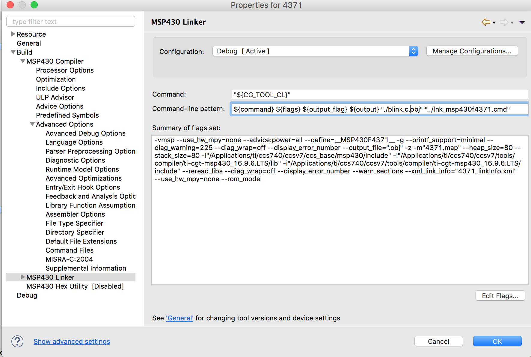

    Below you can see how I used a build variable that represents the name of the input file and passed that to --output_file and added .obj on the end.
    I believe this does what you want but I have not tried on a .asm file but it should work for that too.

    "C:\\Users\\SCOTT~1.BEC\\AppData\\Local\\Temp\\118163", line 41: error #10008-D: cannot find file "./MAIN.obj"
    I suspect that I need to change the Command-line pattern from:
    ${command} ${flags} ${output_flag} ${output} ${inputs}
    to something else. It looks like the ${inputs} is still passing in my_c_file.obj instead of my_c_file.c.obj.
    Scott
  • ${inputs} would be a list so that would be hard to override without specifying the full list manually.  I did that here:
    The pain with this would be needing to update it every time you add a file.
    I will check with our build guy to see if there is another way.
    John
  • John,
    You are correct, specifying the files manually works. If you get an answer on how to do this in a more automated way that would be appreciated.
