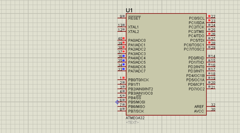

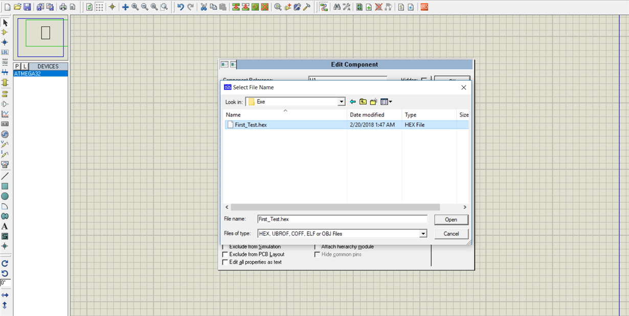

  • I want to explain the matter a bit more in order to show what I really need.
    This very simple example is a C based program related to ATmega32 microcontroller  written and compiled in Codevision.
    Then I select ATmega32 in Proteus and import the hex code that was compiled by Codevision to the project in simulation software(Proteus).
    Thank you for the two last links you sent me, but I have seen them.
    #include <mega32.h> #include <delay.h> #define PO PORTC void main(){ DDRA=0xff; PORTA=0x00; DDRB.0=1; while(1){ PO='S'; PORTA=0x0f; PORTB.0=1; delay_ms(100); PORTA=0xf0; PORTB.0=0; delay_ms(100); } }
