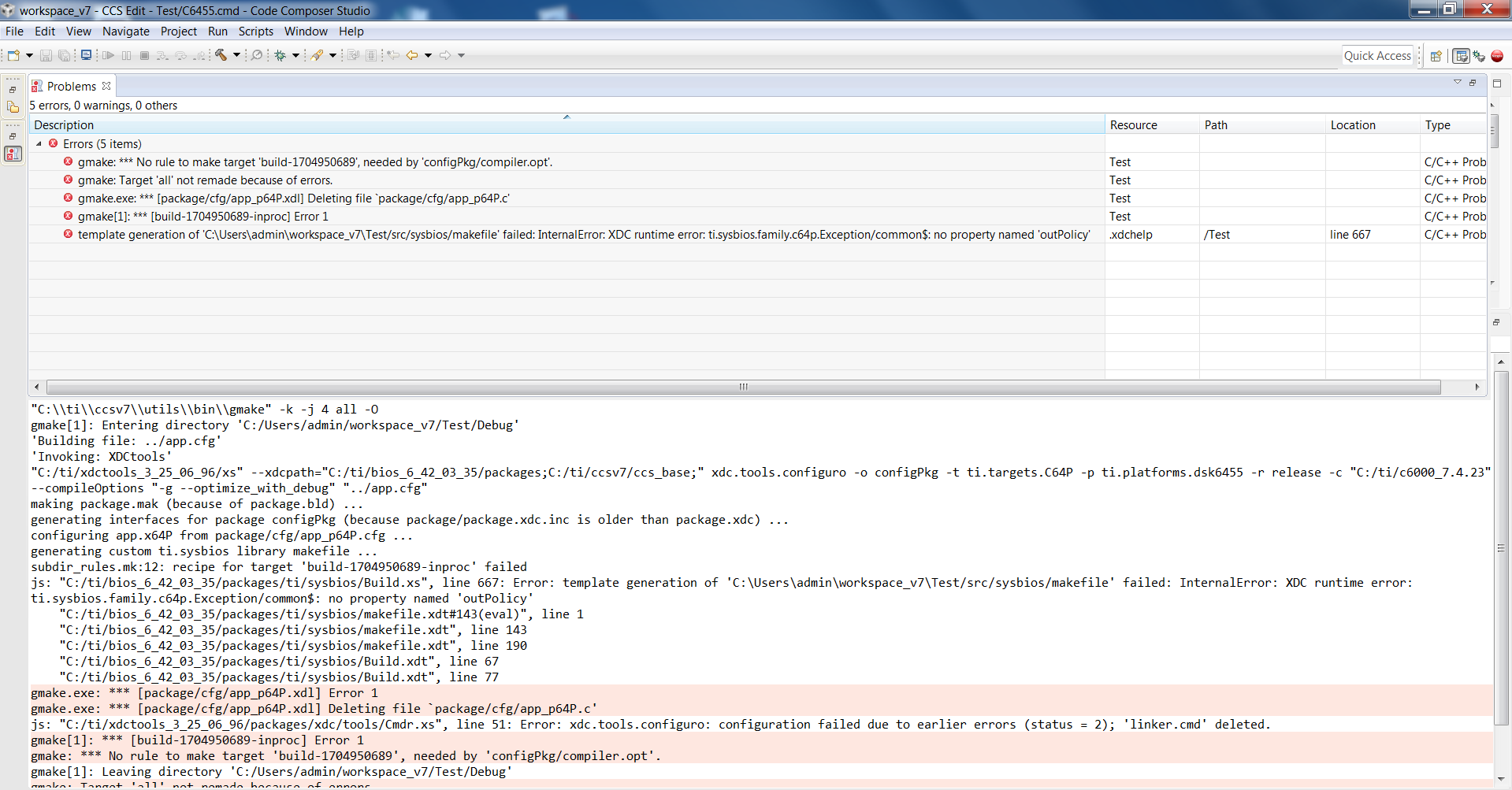

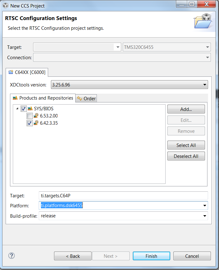

I am trying to compile with CCS v7 for a TMS320C6455 processor.
I am pasting screenshots to show my process so far, any suggestions or tips on how to get this to build and debug would be great.
Originally the compiler was set to version 8, but it said it didn't support the C6455 and to get an older version. I am trying with compiler version 7.4.23.
Again, it had issues with the XDCtools version, had to be before 3.30, so here I am trying 3.25.6.96.
Also the sys/bios had to be an older version.

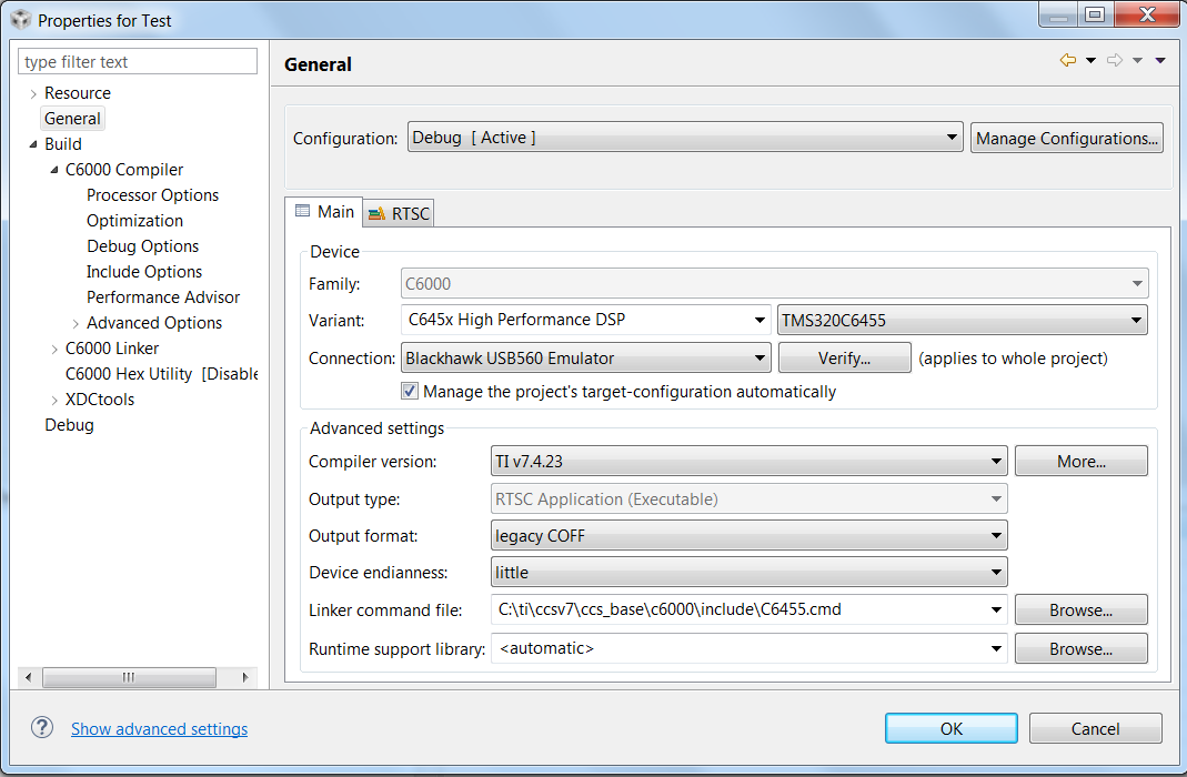

Here I am setting the connection to the BlackHawk USB560 Emulator and setting up the linker to be the C6455.cmd. I tried verifying the connection before and it said it failed. I didn't attach screenshot here but I can if necessary.

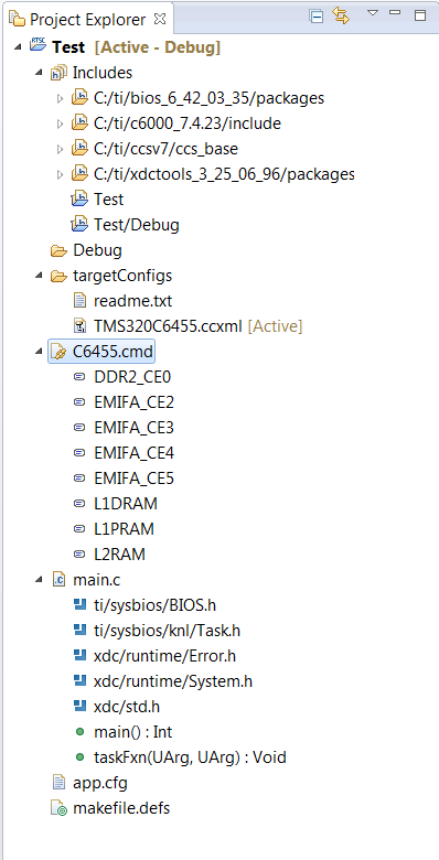

This is just showing what's inside my project to give some insight.

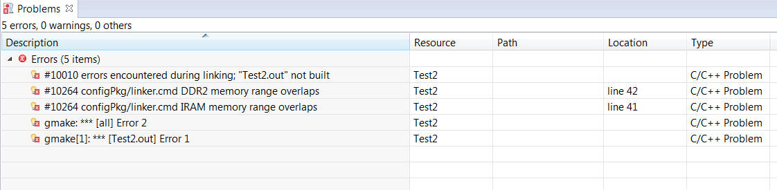

Now this is where I am getting all of these errors. Any idea what's missing?

  • Hi Georgia,
    It looks like xdctools 3.25.06 is too old for the version of BIOS you are using.  I got the same error when building with BIOS 4.42.03.35 and xdctools 3.25.06.96.  I was able to build successfully with xdctools 3.32.01.22.  You can find the xdctools downloads here:

  • Hi Georgia,
    Can you try taking the C6455.cmd file out of your project?  I think it is conflicting with the SYS/BIOS linker command file, that is auto-generated for your project (you can find it in Debug/configPkg/linker.cmd).
    Janet
  • Hi Janet,
    Thank you for that advice, it now builds without errors. The ultimate goal here is to be able to compile CCS v7 on the C6455. It's my understanding that CCS itself works as an emulator, so that means that it doesn't require the physical emulator to be connected in order to be in the debugging stage, right?

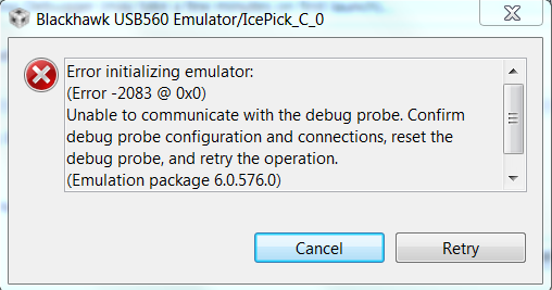

    And after clicking on debug this pops up:
    Is there a step that I am missing or is it possible that the C6455 isn't compatible with CCS V7?

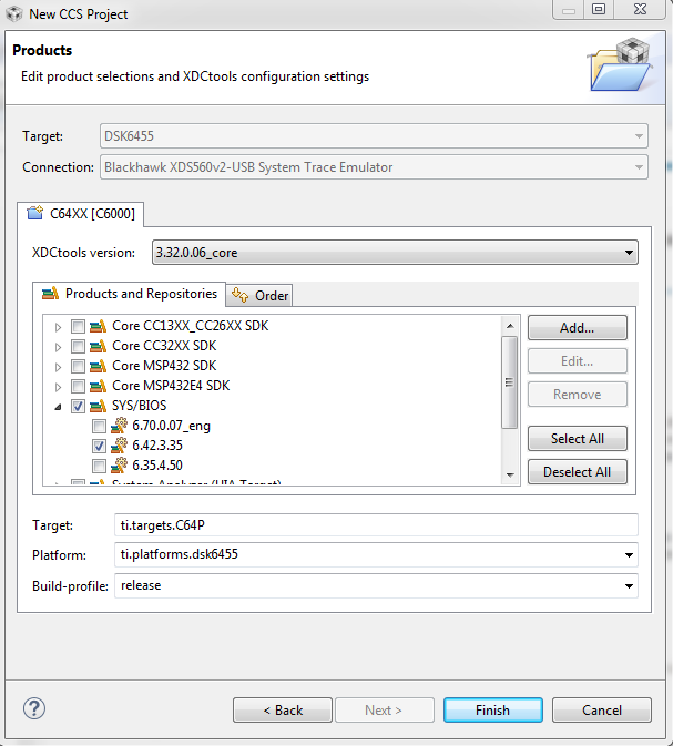

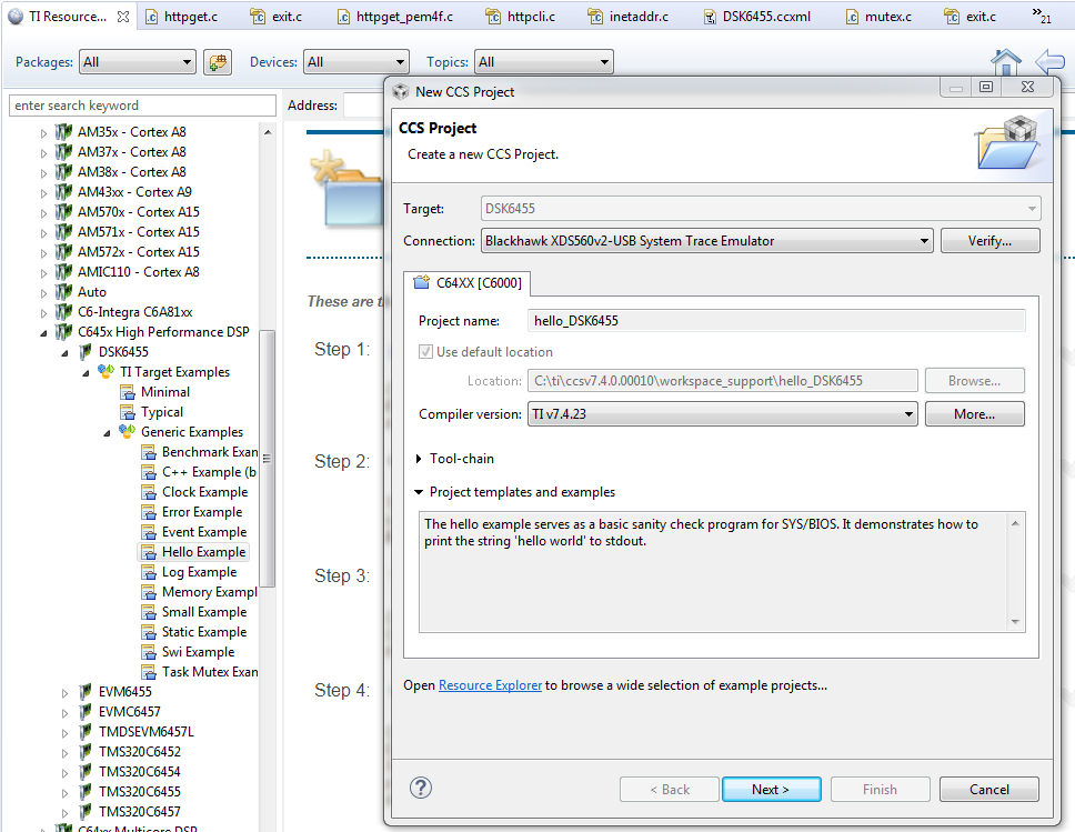

  • Hi Georgia,
    You need to attach one end of the Blackhawk USB 560 emulator to one of the USB ports on your PC, and the other end to the JTAG header on the board.  I used the TI Resource Explorer (Classic) and navigated to SYS/BIOS -> C645x High Performance DSP -> DSK6455 -> TI Target Example -> Generic Examples.  There, you can choose one of the examples, say the Hello Example, to import.  For the connection, I chose the Blackhawk USB560v2 System Trace Emulator (which is the one I have):
    Click "Next" and make sure to set the BIOS and XDC tools versions correctly:
    Then you should be able to build and debug.  I tried this in CCS7.4, so the DSK6455 is definitely supported.

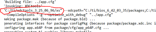

  • Hi Georgia,
    I saw this in your build line:
    Just check the project properties to make sure you are using the newer xdctools.
    Janet
