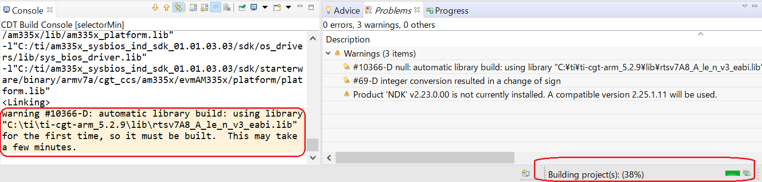

I am not able to build AM335x based projects in CCSv7.
The project build always gets struck while building the library file "rtsv7A8_A_le_n_v3_eabi.lib".
The build doesn't finish even after 1 hour...
warning #10366-D: automatic library build: using library "C:\ti\ti-cgt-arm_5.2.9\lib\rtsv7A8_A_le_n_v3_eabi.lib"
for the first time, so it must be built. This may take a few minutes.
I am able to build MCU (TIVA C/MSP/CC26xx) based projects but this issue
is only with the AM335x related projects.
I had this issue with windows 7 based PC, thought it would solved with new windows 10 PC,
but same issue with new PC and latest CCSv7.
The build progress doesn't move from 38% as shown below.

    The runtime library build does take a couple of minutes to complete, but it is unusual for it to not complete even after an hour. I have not seen or heard of this type of issue before.
    I see that you are building with ARM compiler 5.2.9. To help you move ahead with your development, I am attaching a copy of that runtime library that I just generated on my PC with compiler 5.2.9.C
    However, when you get a chance could you please try the build with a different version of compiler tools (even just the default version that comes with CCS) to check if the version is playing a role here? Also might be a good idea to import the project into a new workspace and try a clean Rebuild.

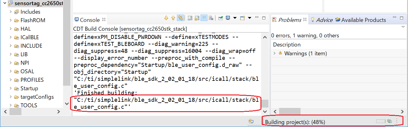

    Today I am trying to build SensorTag sample code,
    it took more than 2 hours, but still the progress is 48%.
    It is taking 15 to 20 mins to build each source file.

  • Paddu,
    I am sorry to hear of the troubles you are having, but it is highly unusual for CCS to have such a huge impact on system performance. I have to suspect something in your PC environment, perhaps a conflict with something else installed on your PC, but I can't point to a specific thing.
    We have recently had some reports of the CCS indexer slowing down the project build and occasionally causing CCS to hang. Disabling the indexer helped alleviate the problem in those cases. Could you give that a try to see if it helps? This post tells you how to disable the indexer.
