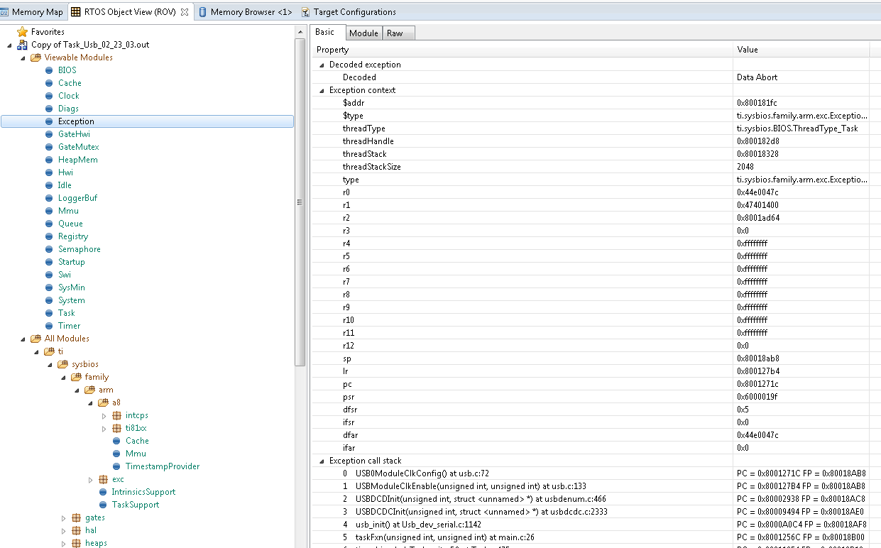

I need to create a static task with *.cfg file.
But I don't know which version xdctool and sysbios are properly.
Colud you tell us  please?

  • Tomiyama,
    you probably defined
    Program.linkTemplate = "task.cmd";
    or something similar in your app.cfg. Do you have the file task.cmd somewhere on the disk? Can you find that line in your app.cfg and post it here?
  • Hi Tomiyama,
    I'm not seeing any issue with BIOS 6.35.04.50 and xdctools 3.25.  They are compatible.  The error indicates that a file, 'task.cmd' cannot be found, so it looks like a file is missing from your project.  Maybe you can clean your project and attach a zipped up version of it here so I can try to build it.
    Janet

  • Hi Tomiyama,
    Are you able to build your project now?  I was able to build the project you posted, but I needed to make a few changes.  I couldn't find the StarterWare version 2.00.00.07 that you are using, so I used 2.00.01.01.  I also had to use BIOS 6.52 and XDC tools 3.50 to get the project to build.  I don't have the hardware to debug your project with, so I need more information on how your program is failing.
    It looks like you started with the non-rtos usb_dev_serial example and made some modifications to it.  Were you able to get the non-rtos example to work?
    If you can provide some more information, that would be very helpful.
    Janet

  • Hi Tomiyama,
    When I try to run your program on an A3359, I get an exception in usb_init().  You can see the details in this ROV screen shot (CCS -> Tools -> RTOS Object View):
    It looks like some peripheral was not powered on?  Here is your project that I modified to get it to build.  I did not modify your source code, only the project settings.
    2570.Copy of Task_Usb_02_23_03.zip
    If you can get your program running, ROV may help to debug.
    Janet
