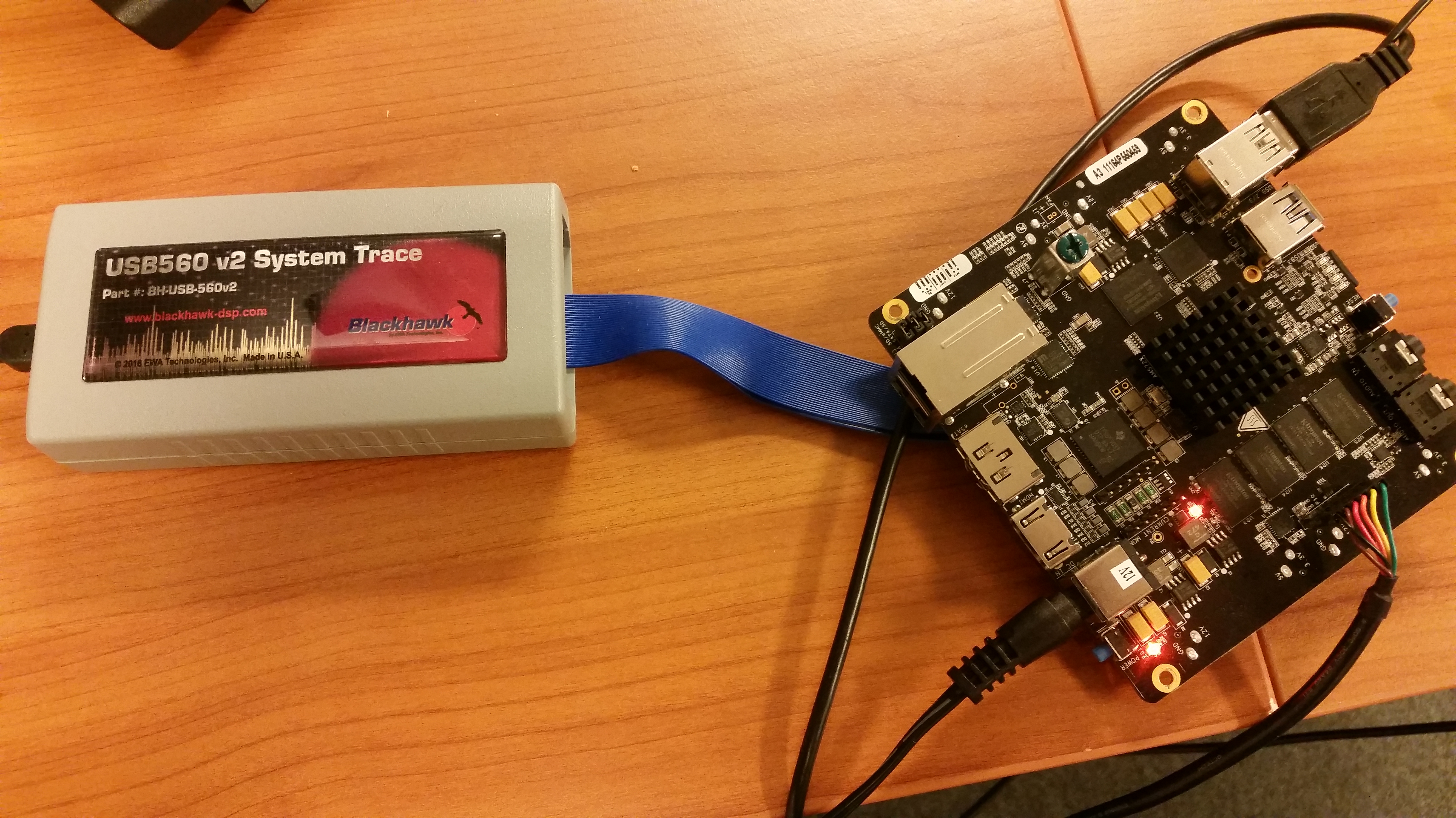

I am trying to do a system trace with TI AM572x EVM. More specifically Memory throughput analysis. I am getting "Uninitialized error text message", as can be seen in the attached video. The video show exactly what and how I am doing. My setup looks like in the attached picture. Could you please help me resolve this issue. Thank you very much for your time.
    A few details:
    - The board you have most probably is not a Silicon Rev A - thus you can use the configuration GPEVM_AM572X instead of the GPEVM_AM572X_SiRevA
    - If your board is the BeagleBoard X15, its schematics indicate it does not have the EMU2~4 pins connected, thus allowing only 1-pin STM Trace

  • Hello Rafael,
    My board is TI AM572x Evaluation Module (www.ti.com/.../tmdsevm572x ). I have removed the screen on top of it. The serial console shows the following output at Uboot.

    The video shows that on the Receiver/Transport Settings for the 560 V2 trace that "Number of Pins" is set to "4 pin":
    As Rafael has already noted the BeagleBoard X15 has only wired EM0 and EM1 to the 20-pin compact TI JTAG header. Can you try setting the Number Of Pins to "1 pin" to see if that stops the errors (of the two EM0 and EM1 pins one is clock and one is STM trace data).
    [I don't have a USB560 V2 system trace to try this]
  • Thank you Chester for the reply. I tried with "1 pin" (please check the attached video). It gives the same errors again. It gives the same errors when I select "2 pins" as well. Any other ideas?
    From the TI AM572xevm_rev_a3a schematic diagram found here (http://www.ti.com/tool/tmdsevm572x) I see that EMU0 and EMU1 pins are connected. Whereas EMU2, EMU3, EMU4 are not connected.

    When used a Spectrum Digital XDS560V2 STM connected to a BeagleBoard-X15 to attempt to configure 1-pin STM trace then CCS 8 reports the error "failed to calibrate channel : transmitter frequency measured at 0 Hz".
    Looking at the .TI-trace\data\TraceCntrl-Spectrum Digital XDS560V2 STM LAN Emulator_0-CT_STM_Config-560V2STM.cfg file created shows pins 2 and 0 are attempting to be used to receive the STM trace data (on the pinMap line I think the first number is the trace clock pin and the remainder are the trace data pins):

    The AM572x TRM SPRUHZ6J shows that only emu2 can be used as the trace clock:
    Therefore, I think to be able to collect STM 1-pin trace from an AM572X pins emu2 and emu0 must be connected, and since the BeagleBoard-X15 only connects emu1 and emu0 to the JTAG connector it is therefore not possible to collect STM trace data.
    Whereas with an OMAP4430 I was able to collect STM 1-pin trace over emu1 and emu0 and the OMAP430 TRM shows that for an OMAP4430 1-pin STM trace can be used over emu1 and emu0:
  • Hi everyone,
    I was chatting with the dev team and found out that what Chester is talking about is sound information.
    Back in OMAP4 days when System Trace was newly released, this capability was enabled with EMU0/1 pins. As the years progressed, newer devices moved the pin trace clock to the EMU2 pin, which matches what Chester is seeing for the AM572x: it requires EMU0 and EMU2 pins to be connected for 1-pin trace (which sounds an oxymoron, but it is 1 data pin trace).
    In this case, there is no way to make the setup work well on the Beaglebone x15 or the AM572x GPEVM. Sorry.
