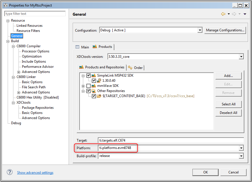

  • First thing, are you sure your project is a RTSC project?  If so, the folder should have a "RTSC" icon like this:
    I'm not sure what RTSC tab you're referring to.  In my project, the "Products" tab has a box where I choose the xdctools version, and down below that I can choose the platform.  Here's a screenshot:
    Can you elaborate on the issue?
    Brad
    It does!
    Same as mine!  I was referencing this thread, see bottom/answer:
    May have seen something to that effect other places as well.
