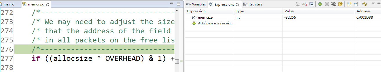

When I configured the Heap size of the device larger than 32768 Bytes, function malloc cannot work any more. I found a variable named memsize had overflow in file memory.c. Because its type is integer.
I am using CCS 7.3.0 Compiler version is 17.9.0.STS.
Is there any solution for this?

In my project, I need a large dynamic List. First I calculated each node was 60 bytes so I configured 32000 bytes Heap and it worked. But after adding more detail in each node I need more Heap, so I configured 33000 bytes. During step debugging I found the problem is malloc cannot be executed. It traced to file memory.c. I found a variable named memsize is overflow. And it is integer. So I retry to configured heap 32768 bytes, malloc function worked well. and memsize is not overflow.

You need to change the data_model from restricted to large, which can be done from the CCS project properties under CCS Build -> MSP430 Compiler -> Processor Options.VinsonShan said:--data_model=restricted
This is because the malloc() implementation in the RTS memory.c uses the signed type ptrdiff_t to store the packet size in the heap, where a negative size indicates a free packet. ptrdiff_t is 16-bits in the restricted data model, and 32-bits in the large data model.
Therefore, when the heap size is larger than 32768 bytes when using the restricted data model when the heap is initialised it is considered that there is no free space.
