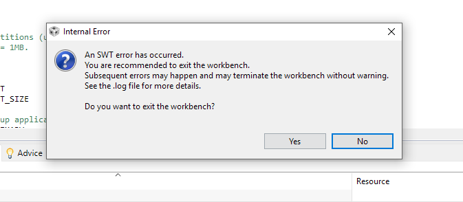

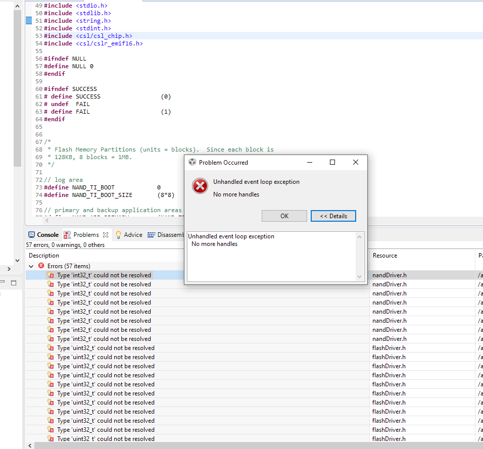

Recently CCS (Version: 7.3.0.00019) started behaving erratically.
1) It doesn't recognize a header file in the PDK install directory, even though the directory should be included in the compile:
From the .cproject file:
2) It doesn't recognize int32_t, etc even though stdint.h is included. Then when I click on the errors I get first this error dialog
Finally, when I close that error dialog I get this message
I've rebooted my computer and still the same behavior.
I've have buggy behavior and crashes from CCS 7 while I've been using it since last July but nothing like this. I can't do anything at this point because I can't build my project. Also, I updated CCS about 1-2 months ago, but not recently.
What the heck is going on with it?!?
Bruce
    When you look at the Project Properties->Build->Compiler->Directories->Include paths options, do you see the path to ${COM_TI_PDK_INSTALL_DIR}/packages/ti getting resolved properly. You can hover over the 3 dots next to the path to see what it resolves to.
    For the unhandled exceptions and SWT errors it appears that there might be some instability or workspace corruption going on. Could you try importing the project into a new workspace to see if it helps with those specific issues?

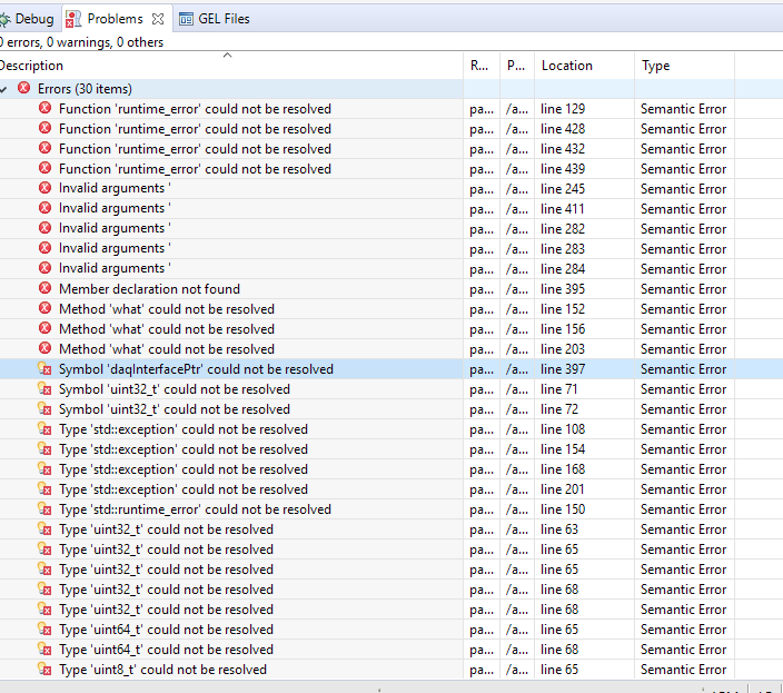

  • I don't know what it means to "periodically clean out" and Eclipse workspace. There is no option to "clean out" the workspace that I can find. And now, once again, only a week later we seem to have the same exact kind of erratic behavior.
    I cloned a git repository with our latest delivered master branch. A colleague can compile it without error. However, when I try to build it I get all of these "errors" are displayed in the "Problems" window.
    Meanwhile, in the Console window, the program compiles perfectly and I can load and run it without problems. So there aren't actually any errors in the code.
    Please see this wiki section for more information: http://processors.wiki.ti.com/index.php/Troubleshooting_CCSv7#General_IDE
    These are Semantic errors likely coming from the built-in static code analyzer that comes with Eclipse. Please see this page for more information on when these errors may occur and how to clear them out. As you said they should not affect your project build,especially if there are no errors in the build console.
