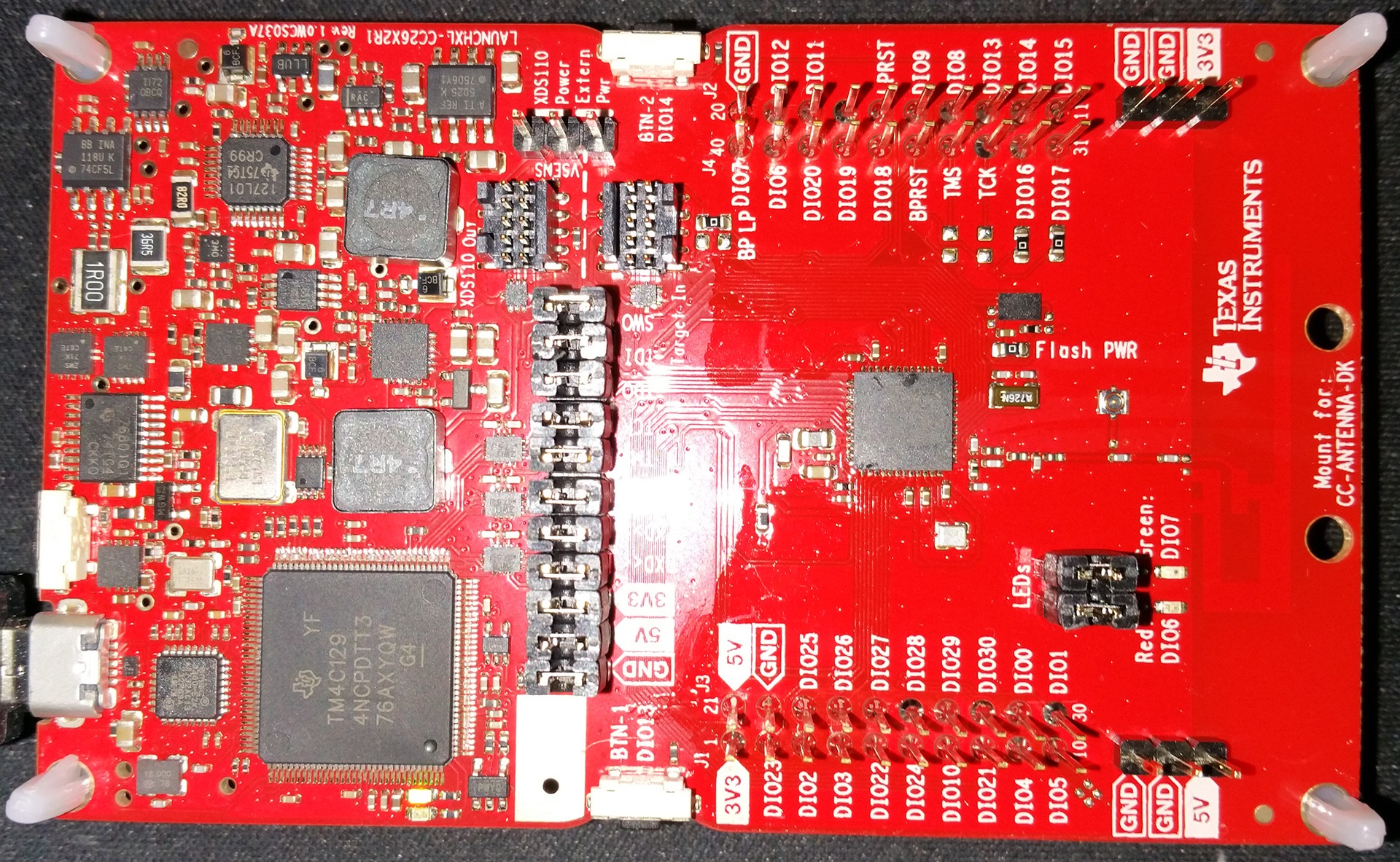

Hello experts,
 I have a following issue. I have bought a new launchpad CC2652R but it cannot be programmed. I have tryed to program the board with CCS (Last version) and IAR (8.20.02)
The error from CCS and IAR is the same:
Error connecting to the target:
(Error -242 @ 0x0)
A router subpath could not be accessed.
The board configuration file is probably incorrect.
(Emulation package 7.0.100.1)
P.S. The board was delivered withot jumpers for SWO, TDI and TDO. Adding of the jumpers did not resolve the issue. Ones the board was switched on none of the LEDs went on. (According to my experience with previous versions of Launchpad (CC2650) it is unusual, because some stack (e.g. BLE) was always preprogrammed and functionable as indicated by LEDs...)
I have made a photo of the board (jumpers are added by myself):
