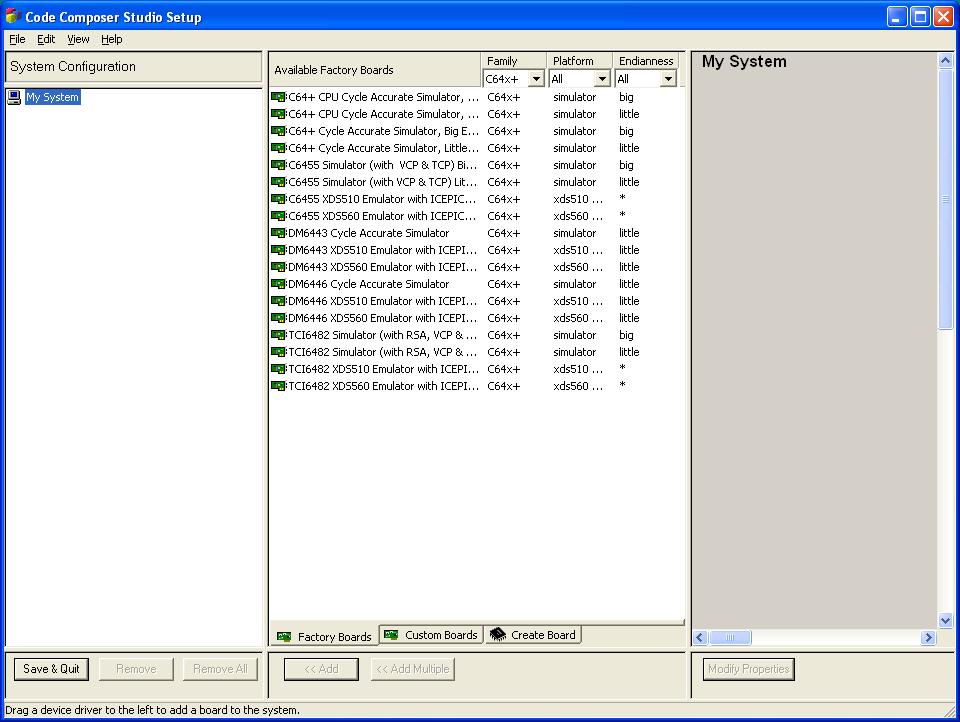

I am a new user of the TMS320DM648, we purchased the DVDPboard which I have set up and it is presently running the demo app in the stand alone mode, following the instruciont of the getting started guide. The next step is to run the demo with the PC host app. For this, the CCS must be set up with either an emulator or a simulator (per the instructions). I do not presently have an emulator, so how do I set up CCS? Attached is the list of options under available factory boards, none of which are what the guide says should be used.
    I don't have a getting started guide here with me, but since the DM648 device is essentially a C64x+ device either the Cycle Accurate or the CPU Cycle Accurate simulators can be used. For details on what each simulator supports please check the list in the link below:
    http://processors.wiki.ti.com/index.php/List_of_Simulator

    Yes, you will need a JTAG emulator as the ethernet port does not allow programming the device. Once the board software is installed, some ready-to-run CCS configuration files are included in the directory below:
    C:\Lyrtech\EVMDM648\ccs
    These files can be imported to CCSetup by going to menu File --> Import.
    In any case I suggest updating your CCS to the latest Service Release 12. This way you will have a more complete list of supported devices, as well as bug fixes and other updates.
