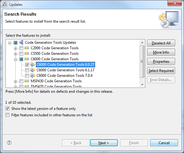

    In CCSv4.1.3, follow this procedure:
    - Go to menu Help --> Software Updates --> Find and Install
    - Select New Features to Install
    - Check the box close to Code Generation Tools Updates and click Finish
    - Under C6000 Code Generation Tools you will see release 6.0.27 (the latest in the 6.0.x tools branch)
    Restart the workbench; it will finish installing the updated tools and reopen CCS

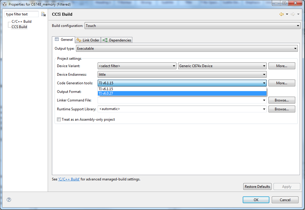

    Even still, if you have worked to port your existing project to CCSv4 you won't lose it. To use the newly installed tool from within the IDE, right-click on the project and select Build Properties. Select CCS Build in the tree on the left and the tool version in the Code Generation Tools drop-down menu.
    At last, if you created your CCSv4 project from scratch during the porting you will have to select a different Run-time support library from the project linker options (right-click on the project --> Build Properties --> C/C++ Build in the left tree --> C6000 Linker --> Include library file or command file as input) . The 6.1.x tools' new linker performs an automatic selection of the run-time support library, which points to <libc.a> and does not exist in 6.0.x.
