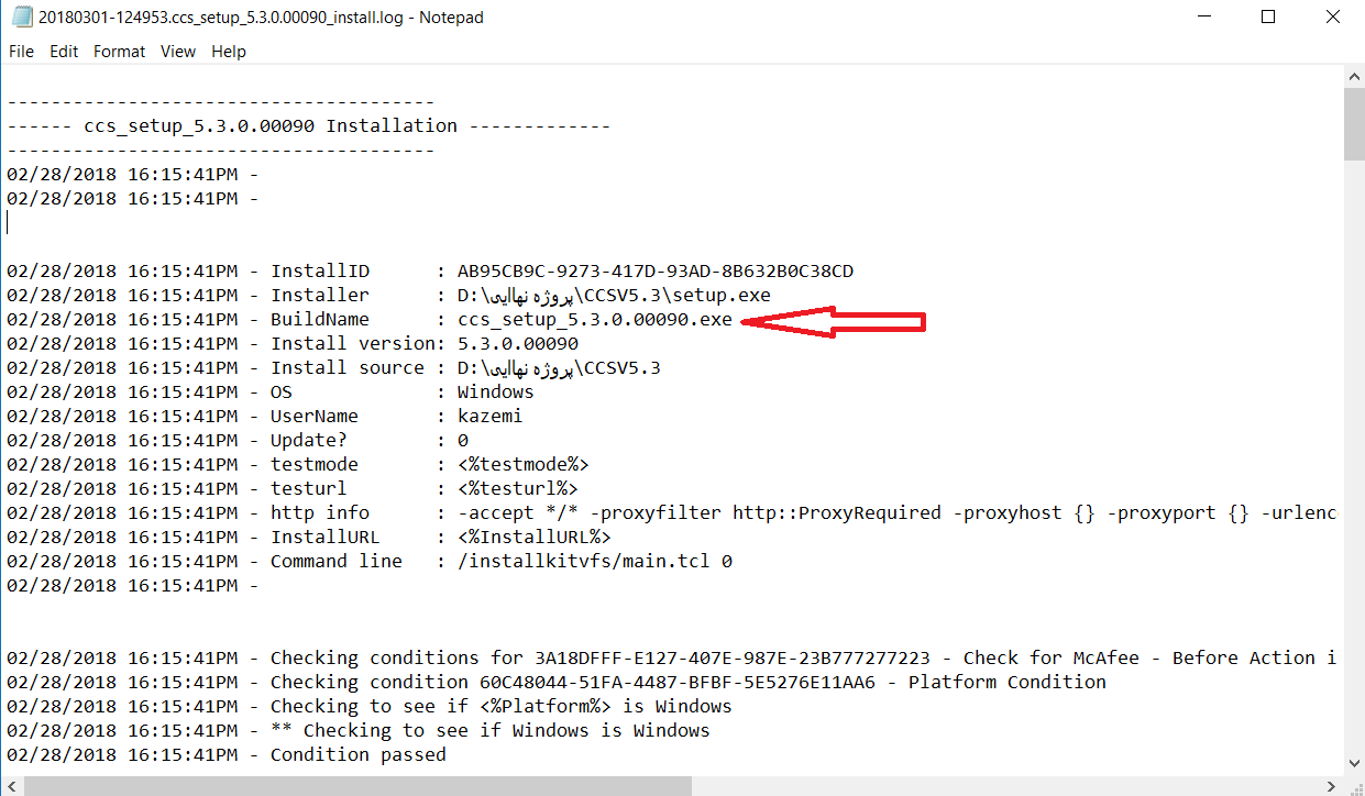

Compiler: I have a new problem when I want to install Code Composer Studio.
I have installed CCS  for many times but recently I have been faced two new problem while I was installing CCS on two different PCs. Would you please help me? How could I fix it?

  • Hi Hossein,
    #1 - I'm just guessing here, but it looks like you may not have extracted the offline installer from the zip file. If that's correct, please unzip before running. If not, what version are you trying to install? If it's version 5, please zip up the contents of C:\Program Files (x86)\InstallJammer Registry\ccsv5 and post here.

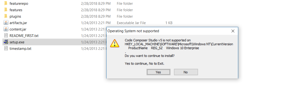

    #2 - CCS v5 is not supported on Windows 10. CCS has a new 7.4 release available.

    #1- Please look at attached file.
    #2- I don't think this would be related to Windows version, because I have installed CCS on Windows 10 and used it properly for building projects, debugging and programming ICs. I 'd like to now your opinion about this. If you are sure so how I  has not been faced any problem related to this matter.

    For #2, it's just warning you that it's not supported, it does allow you to continue to install.
    I would recommend that you delete the contents of the folder C:\Program Files (x86)\InstallJammer Registry and try each install. If you still have problems, please zip up the logs and attach them here for us to analyse.

  • Sorry, I should have been more clear.
    The C:\Program Files (x86)\InstallJammer Registry folder contains all log files created at the time of running installers. So if you run more than one time, the logs get harder to read, which is why I suggested removing the files before running the installer.
    If you're using windows 10, Windows 10 doesn't like files on shares or mounted drives, it wants all the files to be local. Which is why I suggested unzipping the offline installer on the c:\ drive.
    From looking at the log submitted above, I see that your installer is D:\پروژه نهاایی\CCSV5.3\setup.exe.
    Eclipse can't handle any non-ascii characters in paths. Also, the installer name should be ccs_setup_5.3.0.00090.exe. How is it becoming setup.exe?

  • Related to your last sentence,
    I don't agree with you. Please take a look at the image below.The Build Name is OK. It is ccs_setup_5.3.0.00090.exe.
  • Deleting the whole logs folder is ok, it will recreate what it needs to.
    I was just curious as to why the installer was getting renamed (what you're pointing to is it's internal build name).
    You will definitely have to move the installer's complete unzipped package to a folder with ascii characters only. Eclipse can't handle non-ascii characters in the %USERPROFILE% path, the %TEMP% path or the install source path.
    I have done this and everything is ok.
    I have seen similar installer name in the log file of every CCS that I have installed on every system.
    I have done this and my problem has been fixed.
