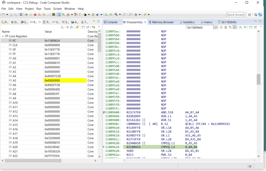

  • As follow-up, even when there is no source available, stepping takes the focus back to the top of the routine.  Again, instead of:
    step, step, step, step
    it's
    step, refocus to stepped lines, step, refocus to stepped lines
    I've attached a picture of stepping through a division routine (without C source), with first image the step point, and the second image where I end up after the step has been executed
    Surprised, given the productivity impact, these issues were not more known, raised.  It's not the behavior of pre-Eclipse CCS (or most other IDE debugging tools I've used).
    Robert
  • The performance impact of single asm stepping appears fairly responsive to me, despite the focus issue... though I am working with pretty small projects.
    Yes, the disassembly window will refocus when you step into a function or loop. I don't think you can disable that "feature" either. If you are exclusively asm stepping, one workaround is to remove the loaded symbols (Run -> Load -> Remove All Symbols). This will eliminate all the refocus issues and make asm stepping more responsive. But you would lose source level debug visibility until you reload the symbols again.

    Yes, and some cases, if I'm doing a lot of assembly debugging, it's a standalone, assembly-only module, exclusive like you said, so this disable approach could be used. But that's not always the case.  I'd suggest an option be added to stop the refocusing, for the case where the disassembly needs to be tied to the source level debug.  The source is already interspersed in the disassembly window ... no need to keep referencing back to it in another window after each step.
