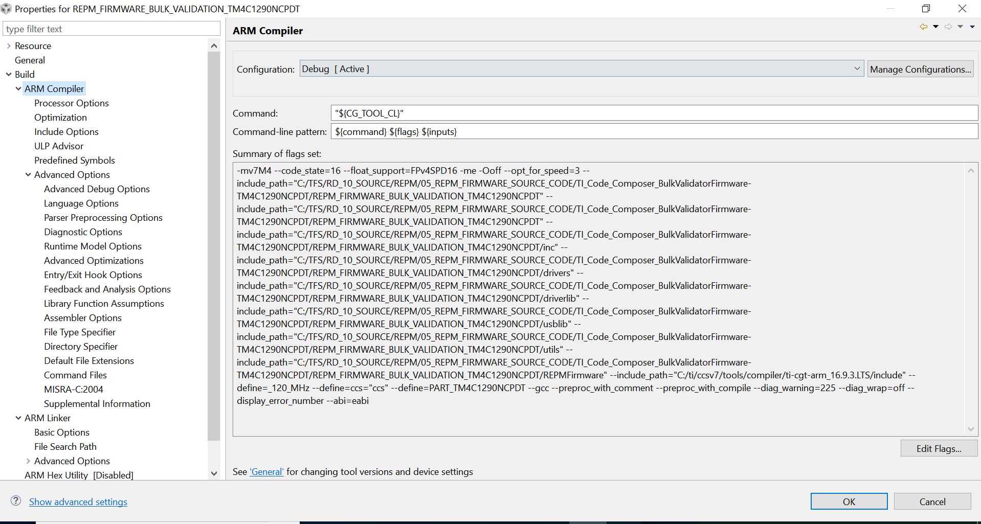

    Edited to attach ARM compiler screenshot. Let me know if you need more information.

  • It's highly likely that you are including this header file twice. Consider adding an include guard to the file.
    en.wikipedia.org/.../Include_guard

    7446.console.txtThank you for your reply. Adding the include guard made the re-declaration error go away.
    However, I don't understand the other compilation errors or warnings I am getting. Would
    you be able to shed any light on this? Thank you again.
    Edited to add: Can you also comment on the warnings from pinout.c? about implicit declaration
    of ROM functions.
    Priya

  • 6683.console18.1LTS.txt
    Thank you for your reply. I have compiled using 18.1.0.LTS.
    Edited to add, I did change the include options to the correct ARM compiler. Current console file attached.
    Its not able to find stdint.h and stdbool.h
    Priya
  • Please note that this issue is a duplicate of CODEGEN-1979, which was fixed in the 16.9.6.LTS release.  Please upgrade your compiler to the latest patch on the branch.
    Anna
  • Can you include a link to this patch? I can find codegen 1979 under closed defects in 16.9.6, where do I go from here?
    Edited to ask: When I installed CCS7.2, I only installed the Tiva ARM MCU. Should I also install MSP 430?
    Priya
  • You can download the latest compiler patch here, as well as view the Closed_defects.html file:
    www.ti.com/.../download.html
    software-dl.ti.com/.../Closed_defects.html
    If you specifically want 16.9.6.LTS instead of the latest, you can get it here:
    software-dl.ti.com/.../download.htm
    You only need to install the MSP430 compiler if you want to compile code for an MSP430 device.
  • Anna,
    I tried installing 18.1.1.LTS and 16.9.6.LTS. Both versions are giving me the same stream of compile errors, cannot open stdbool.h and stdint.h. Why is this?
    Priya
    The executed commands in that log show that you are using the following option:
    --include_path="C:/ti/ccsv7/tools/compiler/ti-cgt-arm_18.1.0.LTS"
    It should be:
    --include_path="C:/ti/ccsv7/tools/compiler/ti-cgt-arm_18.1.0.LTS/include"

    I still don't have any luck. Now its a swarm of linker errors. I appreciate the help.
    Thank you,
    Priya
  • I will focus on the first set of linker errors.
    First, I need to clarify some terms.  When using the TI linker, you typically supply a linker command file.  This is a text file with code that specifies details to the linker, such as giving names to ranges of memory, and how to allocate sections to memory ranges.  When using a GCC linker, there is a similar text file.  It is usually called a linker script.  The details of the code are very different between a linker command file and a linker script.  But they serve the same basic purpose.
    I'm pretty sure the file repmfirmware_Debug.ld (and other similarly named files) is a GCC linker script, and not a TI linker command file.  That's why you see so many errors similar to ...
    "../REPMFirmware/Debug/repmfirmware_Debug.ld", line 10: error #10008-D: cannot find file "INCLUDE"
    I'm not sure of the best way to fix this problem.  Perhaps you are supposed to use a completely different set of linker command files.  Or perhaps this project can only be built with a GCC ARM compiler.  Where did you obtain this project?  Whoever that is can certainly help more than I can.
    Thanks and regards,
    -George

  • George,
    While I am waiting to contact the engineer, I was able to match my project settings with the successfully ported project. I deleted the Stellaris linker files. Can you take a look at the current set of errors and explain why there is a linker error?
    e2e.ti.com/.../669839
    Thank you,
    Priya
  • This entry on the linker invocation ...
    -l"C:/ti/TivaWare_C_Series-2.1.4.178"
    ... is just a directory path.  It should name a file.  Usually a library.
    Thanks and regards,
    -George
