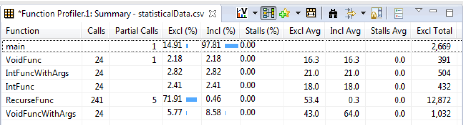

    Maybe my question was not so precise, so I will try to clarify it. I'd like to get below view (or csv file), but only for selected time frame.
    I cannot filter this view by Time.

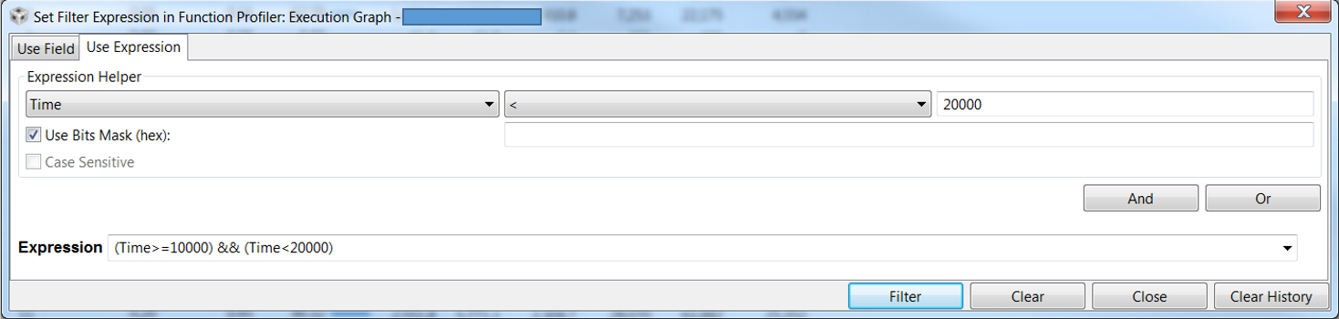

    On the other hand, for instance Execution Graph can be filtered by Time:
