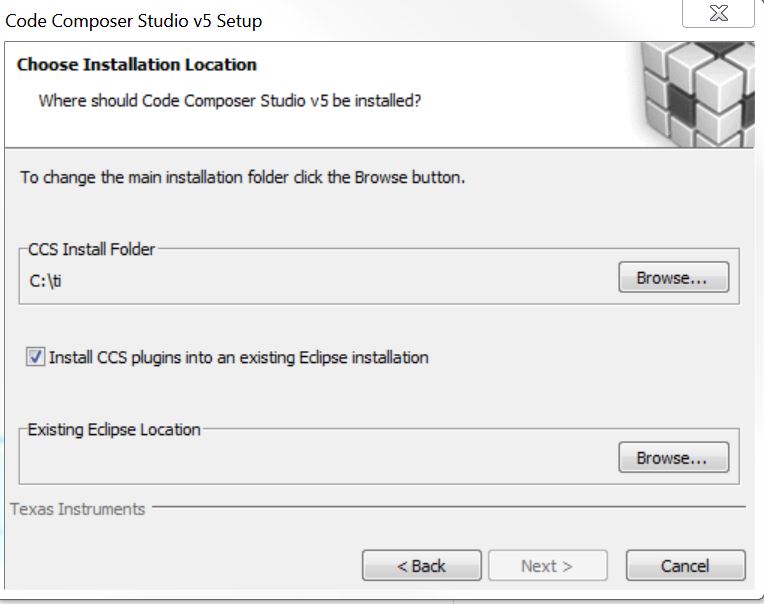

I had asked this question and danish answered me. But I am a little confused. As you can see in the first image bellow, CCS v5.3 could not be installed. When I click on YES icon then in the next page i choose the blank icon "install CC plugins into an existing Eclipse installation.". Then there is nothing to choose and I am not able to continue and click on next icon and start installing CCS.
But what is the reason of confusion?
I was not faced with this problem on some systems but I had this problem on some others. Why? and how to fix it?

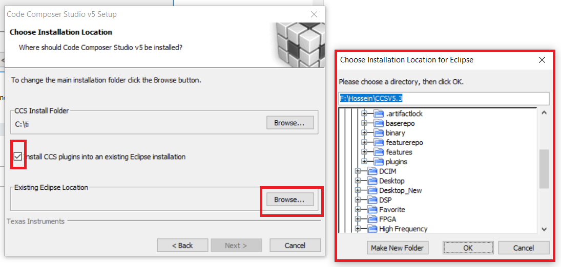

    CCS 5.3 allows users to select an existing eclipse location, for example, if you have eclipse installed in e:\hossein\eclipse, you can browse to it, when you click the check box. See image below:
  • Hi Danish,
    I don't know you may laugh or not?!
    But when I click check box and want to browse installed eclipse, I don't know where to go?!!
    In fact this system belongs to one of my friends and I don't know whether she has installed eclipse or not.

  • Then ignore that option. CCS will install it's own eclipse. We don't support that option in newer versions of CCS anymore.
    If you can move to CCS 7.4, I'd recommend that. There are a lot more features, etc.

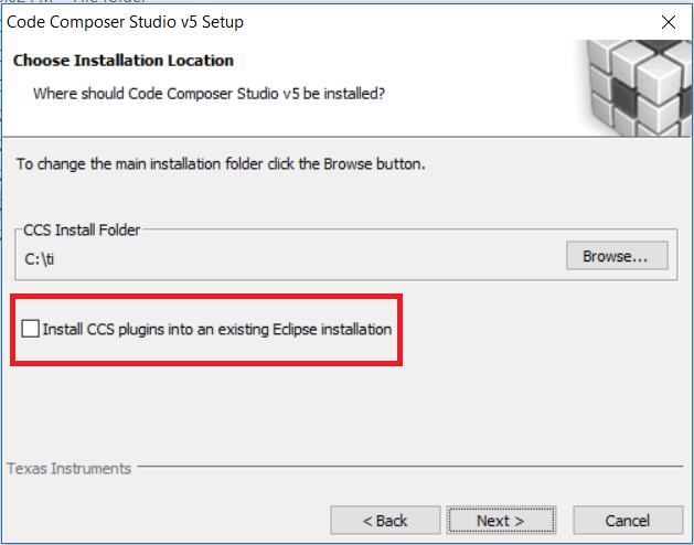

    You said, "ignore that option." OK. Did you mean that I don't mark the checkbox in the image bellow?
    Am I right?
    Am I right?
    Yes, it is best to just install CCS standalone. It will install its own version of Eclipse with it.

    Two, if I ignore this, then a new version of Eclipse will be installed?
    Yes, CCS will install its own version of Eclipse.
