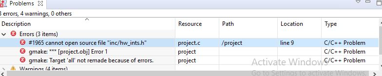

I am getting an error saying it cannot find source file "inc/hw_ints.h". I am not sure what to do to resolve this issue. Do I not have the right library installed, and if so which one is it?

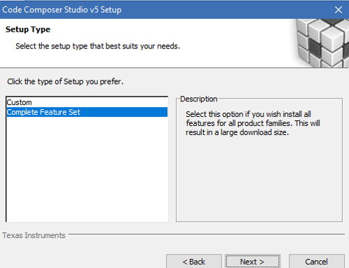

    Did you select "Complete Feature Set"  choice at "Setup Type" page while you were installing CCS?

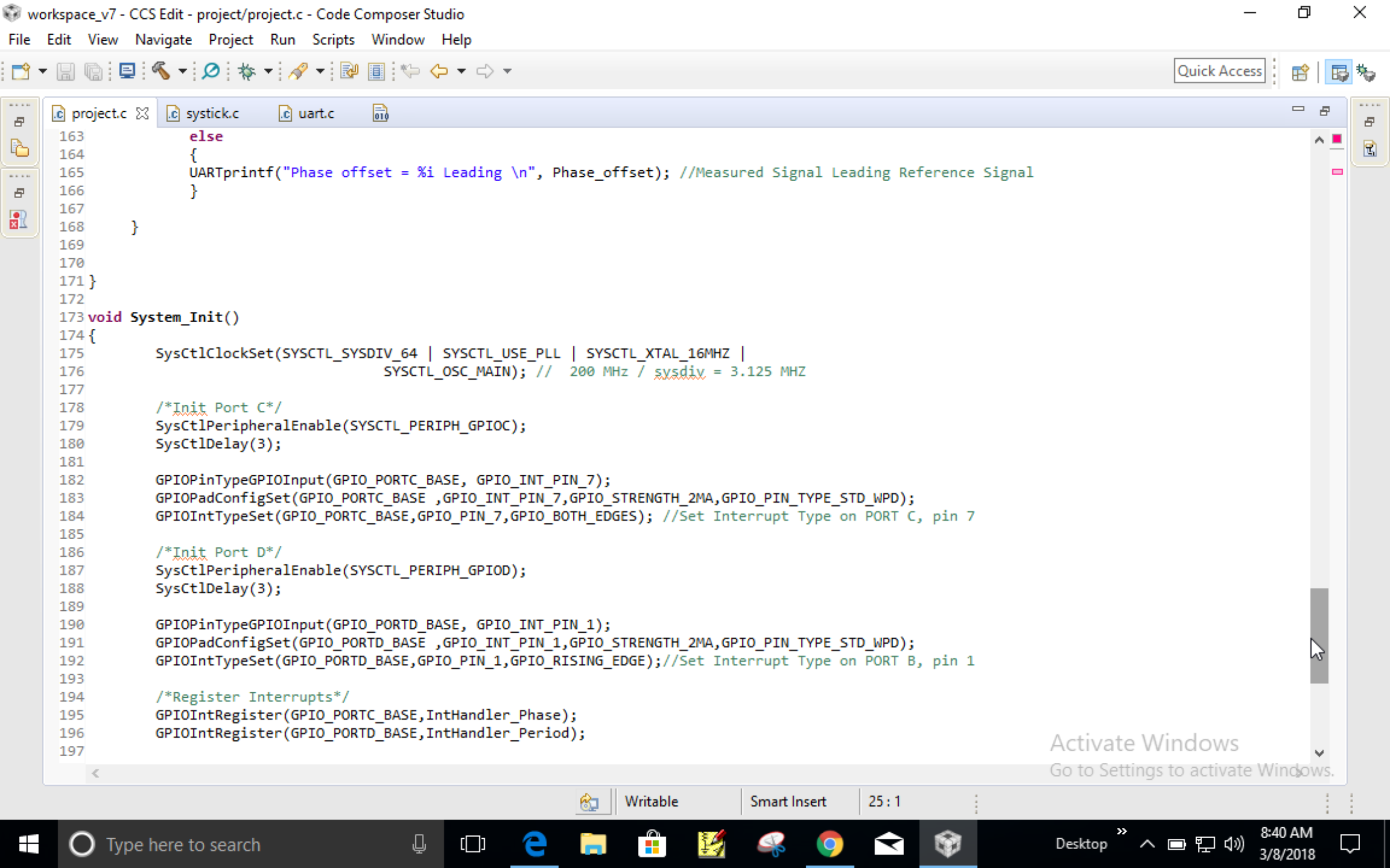

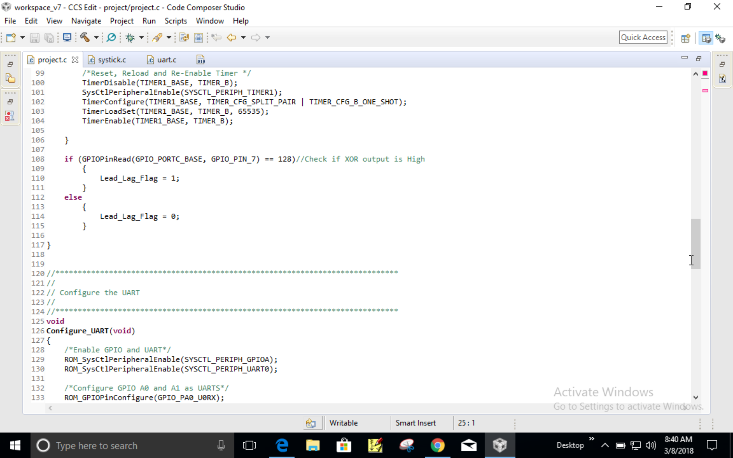

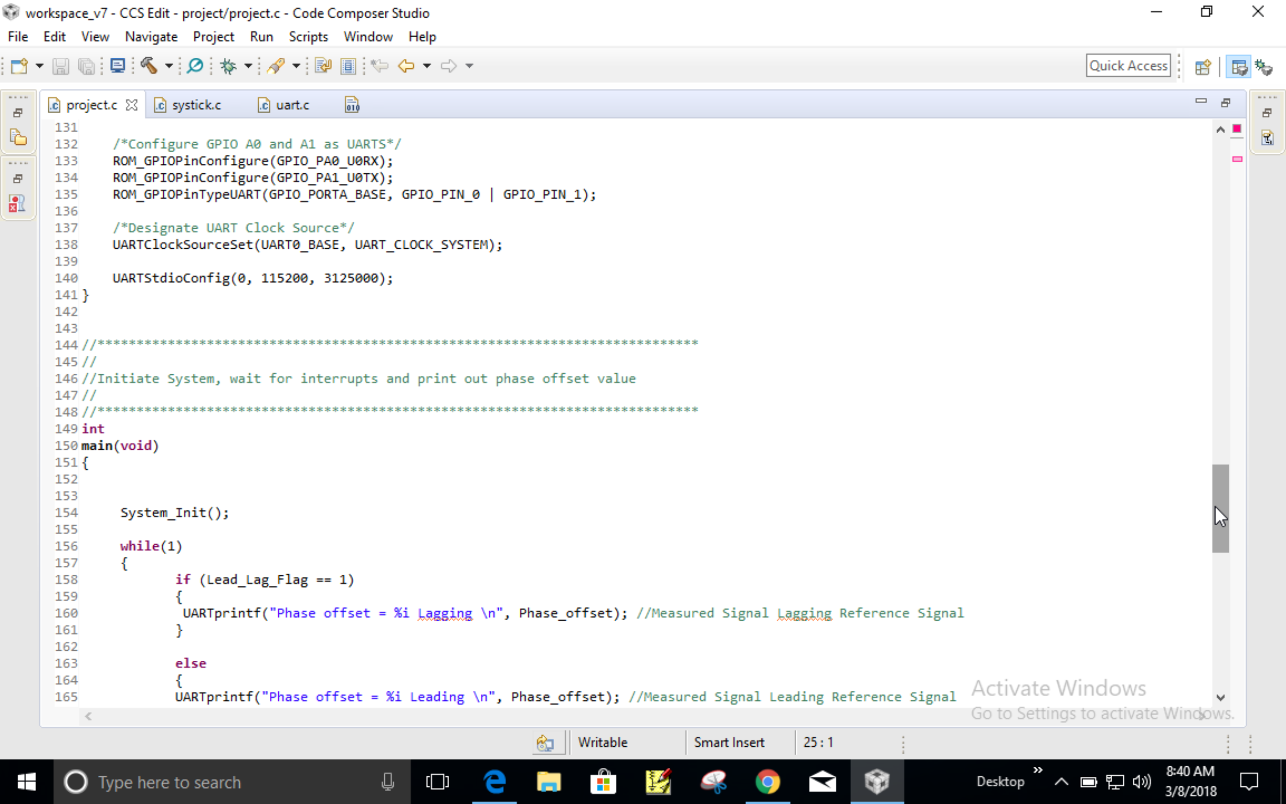

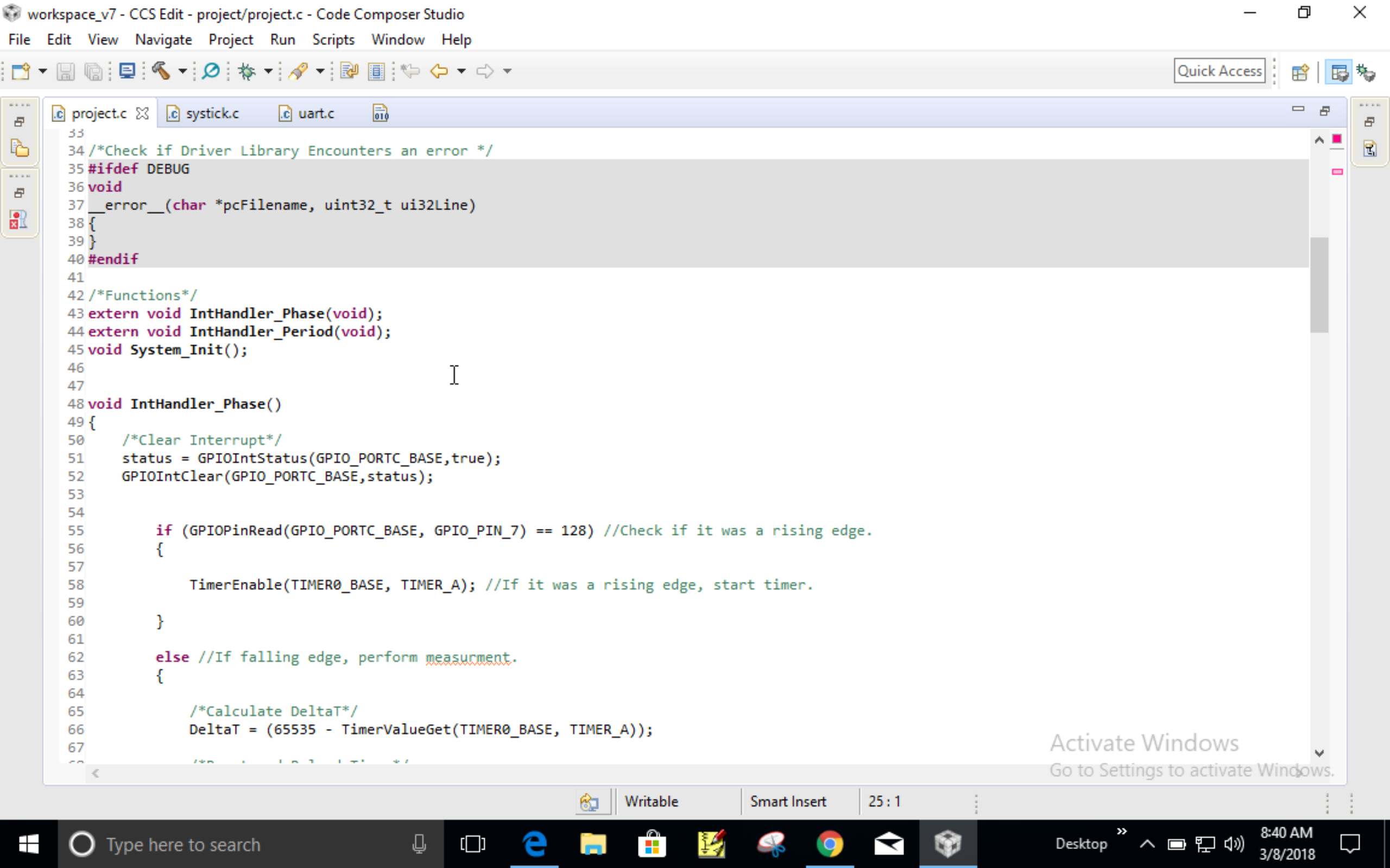

  • Here is the code, the version is V7, and i don't remember if I hit the complete feature set option.
  • Ruben,
    You have the following line in your source file:
    #include "inc/hw_ints.h"
    The compiler is reporting that is it not able to open this file. The compiler needs to know the path to look in for #included files before it can open it. This information is provided to the compiler in the compiler's Include Options (--include_path). More info here.
    In the case of TM4C devices, the path to Tivaware typically needs to be provided to the compiler as "inc/hw_ints.h" is inside TivaWare.
    To fix the error, go to Project Properties->Build->Compiler->Include Options, and under --include_path options, add the path to your TivaWare installation (usually something like C:\ti\TivaWare_C_Series-2.1.4.178).
