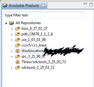

I am working with ccs version 5.5
other packages versions are:
We followed the following steps:

Query: Which option should be configured for enabling these option?
4. We ran the DSP code, But none of the windows got updated and no graphs are updated.
5. Sometimes the data is stored in the temporary folder and after execution all the sub folders are deleted.
Query: How to save the analysis data to the CSV file before execution.
Query: Are we missing any configuration settings? or missing any process steps?
Note: I am using unlicensed version of CCS. Is this reason for unexpected behaviour of system analyser?
