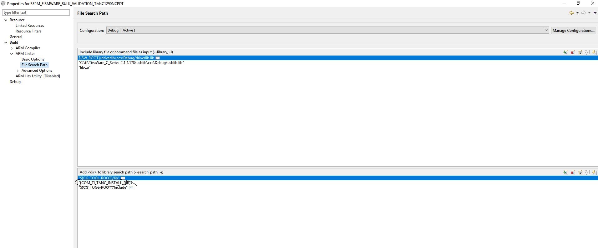

  • I'm unable to track the -l option in the CCS project settings. I am looking at ARM linker flags and ARM compiler flags. Where can I find it?
    Priya

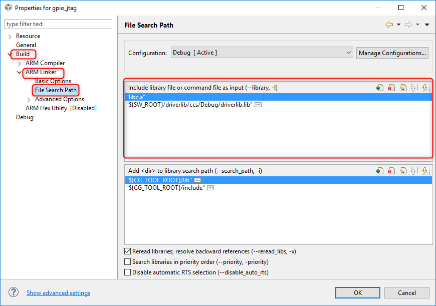

  • This is what I have under basic options ARM linker. What is missing from this?
    Priya

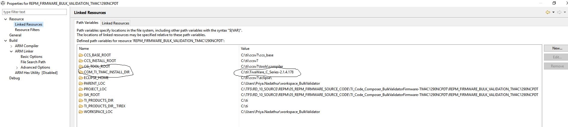

  • Your screenshot does not align with the build output you provided. In your screenshot, I see three libraries specified with the -l option - driverlib.lib, usblib.lib, and libc.a
    Your build output shows:
    -l"C:/ti/TivaWare_C_Series-2.1.4.178"
    -l"C:/TFS/RD_10_SOURCE/REPM/05_REPM_FIRMWARE_SOURCE_CODE/TI_Code_Composer_BulkValidatorFirmware-TM4C1290NCPDT/REPM_FIRMWARE_BULK_VALIDATION_TM4C1290NCPDT/driverlib/ccs/Debug/driverlib.lib"
    -l"C:/ti/TivaWare_C_Series-2.1.4.178/usblib/ccs/Debug/usblib.lib"
    -llibc.a
    And you can see, there are four -l options.
    Where is that first -l option coming from? That is the confusing thing. The path you circled in your screenshot is for a search path (-i option) and unrelated.
    ki

    Ki,
    Thank you for your replies. I am attaching the currently used file search path options, console logs and error list to this post. Please let me know what else I can try. I believe the -l problem is gone now, but I'm having trouble with the ROM functions inside pinout.c file. Why are these ROM functions implicitly declared?
    Edited to mention:
    I turned of the ULP advisor to remove warnings from the console logs.
    Thank you,
    Priya
  • Ok, this looks better. That odd -l option pointing to the TivaWare root directory is gone.
    Now you are back to more unresolved symbols. I don't know where they are defined but you need to add the library/object file for them. If they are from TivaWare, perhaps the experts in the TM4C forum can provide some more insight.
    ki
    To use the ROM functions a TARGET_IS_TM4C129_<version> define is needed to select the device. See the Direct ROM Calls section of the TivaWare Peripheral Driver Library Users' Guide.
