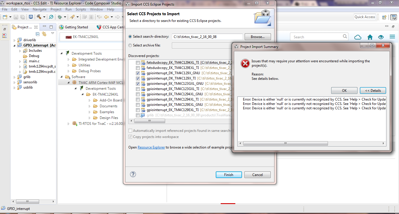

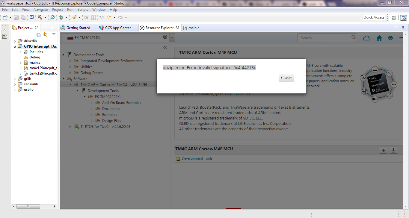

Whenever I am trying to install any software or updates this error is coming:-      unzip error: Error: invalid signature: 0x4f44213c
or
 Error: Device is either 'null' or is currently not recognized by CCS. See 'Help > Check for Updates' or visit CCS App Center to get the latest device support. Error: Device is either 'null' or is currently not recognized by CCS. See 'Help > Check for Updates' or visit CCS App Center to get the latest device support. Error: Device is either 'null' or is currently not recognized by CCS. See 'Help > Check for Updates' or visit CCS App Center to get the latest device support.
And when I am updating the CCS studio, it showing No Updates.
    What exact version of CCS are you using?

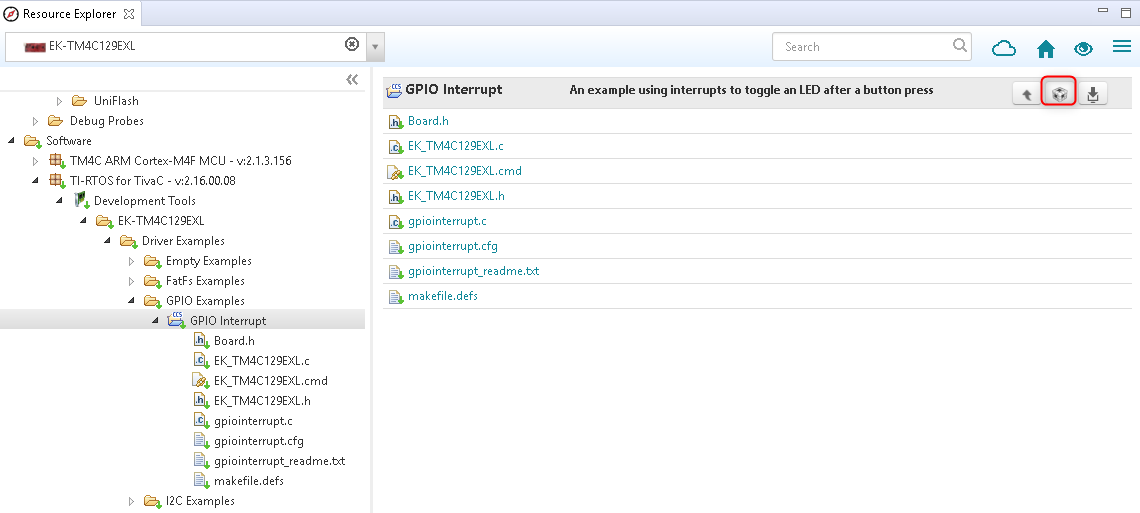

    This is because the projectspecs you are trying to import is not designed to be imported outside Resource Explorer. Please use Resource Explorer to import the project (I can see in your screenshot that TI-RTOS for Tiva is installed successfully on your PC):
