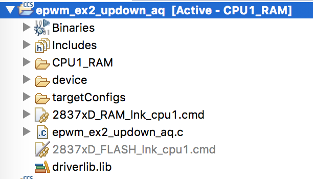

  • Haque,
    When I see a series of messages about overlapping memory ranges that usually means that there is more than 1 linker command file in the project.  I just imported this example from Resource Explorer and it builds fine.  It has 2 linker command files in it but one is excluded.
    You can see the 2837xD_FLASH_lnk_cpu1.cmd file has a line through it.  Did you happen to change that file to not be excluded?  Do you see more than 1 linker command file in your project?
    John
  • Hi John,
    Thank you for your response. Yes exactly that happens and I found two same linker file was in operation at the same time.
    This helps me a lot and resolve my issue.
