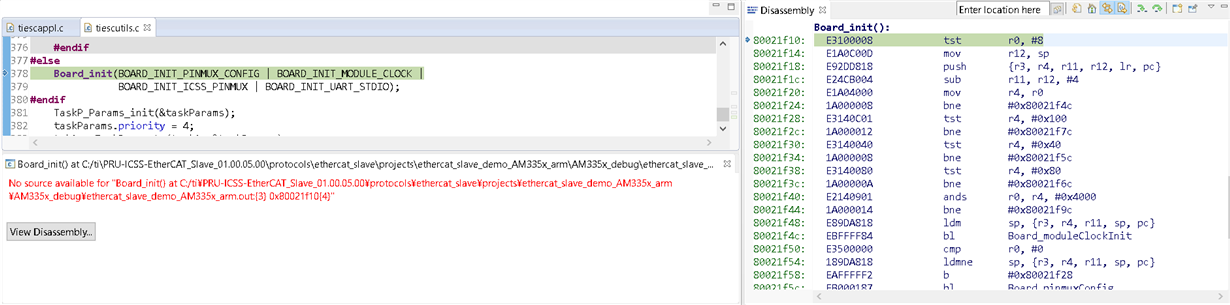

In CCS v7.3, I can't refer to the C source file of the library function. When I used CCS v6.x, there was certainly an icon of "Locate File" of "Method #1" introduced in the following presentation. Please give me some advice.

    The most common cause of this is that the included library was compiled with high optimization or without full debug symbols (or both). This would prevent the debugger from correlating the source code with the address. That is why the option to locate the source file is not available.

    Thank you for your information. Building Library with Debug configuration, I was able to see the "Locate File" icon and the source code.
    However, it seems that I can see the icon even if I change the compiler and linker option of Debug configuration to the same option as Release configuration. For example, deleting -g and adding -O2 in Debug configuration.
    In other words, rather than the difference in compiler and linker options, it seems to be due to the difference in Debug and Release configuration. Though I don't know what the difference is specifically.

    ah, yes. That makes sense. Each build configuration (like Debug and Release) can have its own set of project options. This includes compiler/linker options among others. Usually, the Debug configuration is enabled for debug (-g and minimal optimization, linking in debug version of libraries) while the Release configuration is built with less debug visibility. But there is no guarantee
