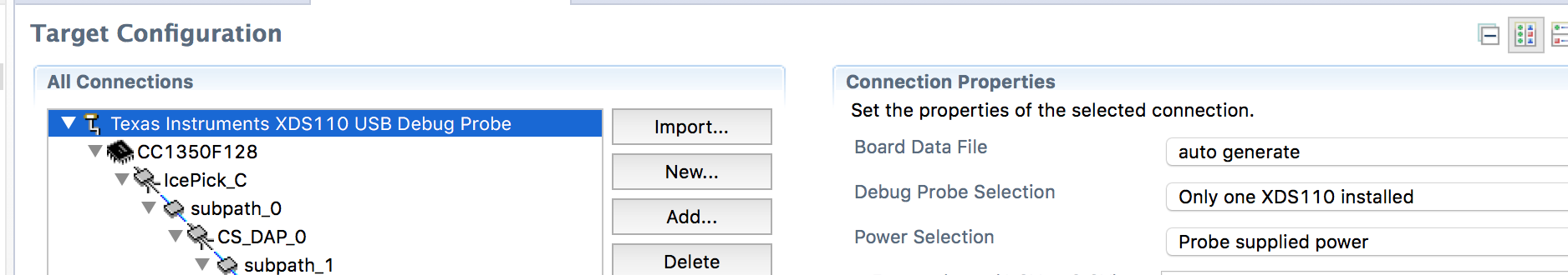

    Here are some screen captures for any others reading.  If you have multiple LaunchPads connected (which is reasonably likely when using a SimpleLink device) you will get a dialog like this the first time you launch the debugger prompting you to select which one you want to use:
    That selection then gets stored in the .ccxml file and then used automatically from that point on.  However if you want to clear that selection it is possible to do so.  One way is to edit the ccxml file automatically.  Or you can use the ccxml file editor.  Just double click on the .ccxml in ccs.  It is usually in the targetconfigs folder in your project.
    Then click on the advanced tab at the bottom.  Select the debug probe in the tree on the left.  The properties are on the right.
    If you change to to "Only one XDS110 installed" it will prompt you to select the next time you launch the debugger.  Or if you know the serial number you can just edit it.
