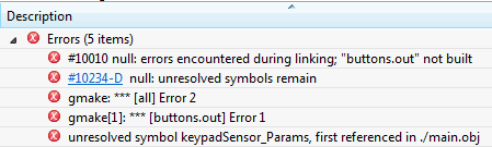

CCS/MSP430FR2633: unresolved symbol keypadSensor_Params, first referenced in ./main.obj
Part Number: MSP430FR2633

  • Hello Gourav,
    I tied to build your code and the only error I got was " identifier "BTN00" is undefined".
    I see you have #define keypadSensor    BTN00  in your code and there is no need to define keypadSensor as BTN00.
    What I did is removing this #define keypadSensor    BTN00  and changed the call back register function to MAP_CAPT_registerCallback(&keypadSensor, &my_button_callback);
    And I was able to build your code with no errors.
    If you still have problems build the code please let me know.
    Yiding
  • Hello Yiding ,
               I have corrected my code as per your suggestion. But still I am getting the keypadSensor undefined and if I include it i am still getting error. Errors are as follows .
    By commenting the #define keypadSensor                                                                   By un-commenting keypadSensor
  • Hello Gourav,
    Could you please share with me your CCS project so I can help you debug the errors you are experiencing?
    Yiding

  • Hello Gourav,
    I changed line 101:
    MAP_CAPT_registerCallback(&BTN00, &my_button_callback);
    to
    and it build with no error.
    Yiding
