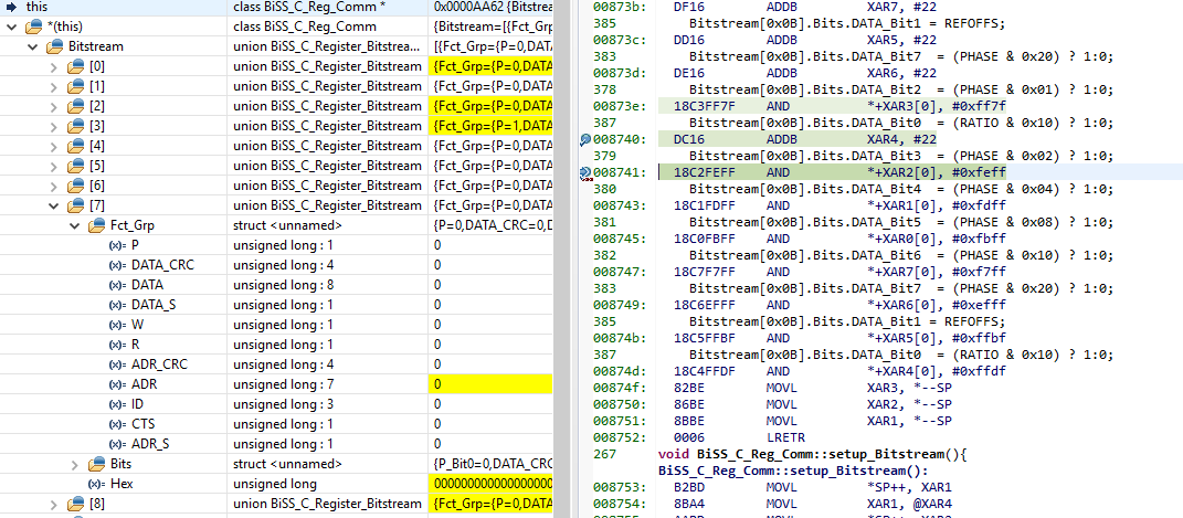

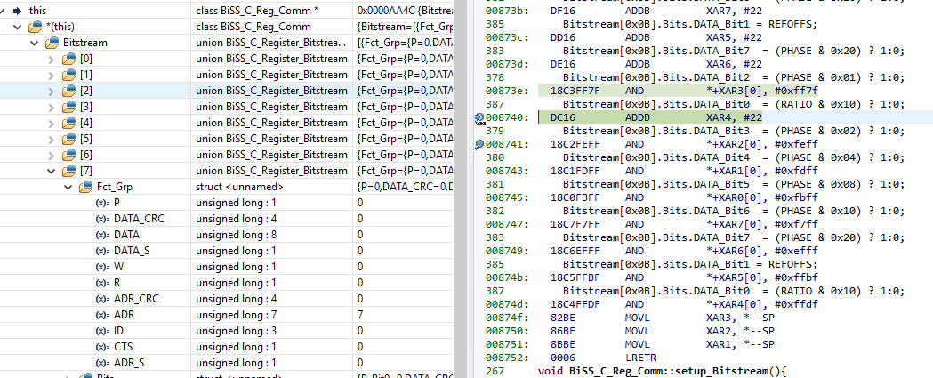

    -opt 02 generates the following problem with the data inside Bitstream[7].Fct_Grp.ADR
    Here everything is fine:
    But when running the next line of assembler Code something goes wrong:
    the Data inside Bitstream[7].Fct_Grp.ADR changed from 7 to 0 which clearly isn't the purpose of that line of Code.
    More Erros with the ADR inside Bitsreams are accuring and with these errors the external IC is setup wrong and won't work.
    I have few to no experience with assambler on your devices and I can't fiure out what is going wrong.

    Marcel Kummer said:
    What the big Problem ist, is that some totally different data inside the Bitfield gets corrupted when the compileroptimisation is activated.
    Part of what confuses you, I suspect, is the reordering of the instructions.  Look at the source line numbers in your screen shot.  385, 383, 378, and so on.  No where close to original source order.  The instruction or instructions which follow a C statement is not the full implementation of that statement, but only part of it.  That's why you see line 383 show up twice.  I realize this is confusing.  But it is part of what you have to live with when you step through optimized code.
    I cannot explain what happens between those screen shots.  Which instruction gets executed?  Keep in mind that, due to pipelining, it could be an earlier instruction that your screen shot does not show.  I don't know enough details about C2000 to say.  If you want to get into this even deeper, then we need to involve some C2000 device experts.
    Thanks and regards,
    -George
  • Thanks for the detailed answer, that helped me understanding what is going on.
    I misunderstood the influence of volatile to the compileroptimization and excepected some other behaviour.
    That's why I thopught the data got corrupted.
