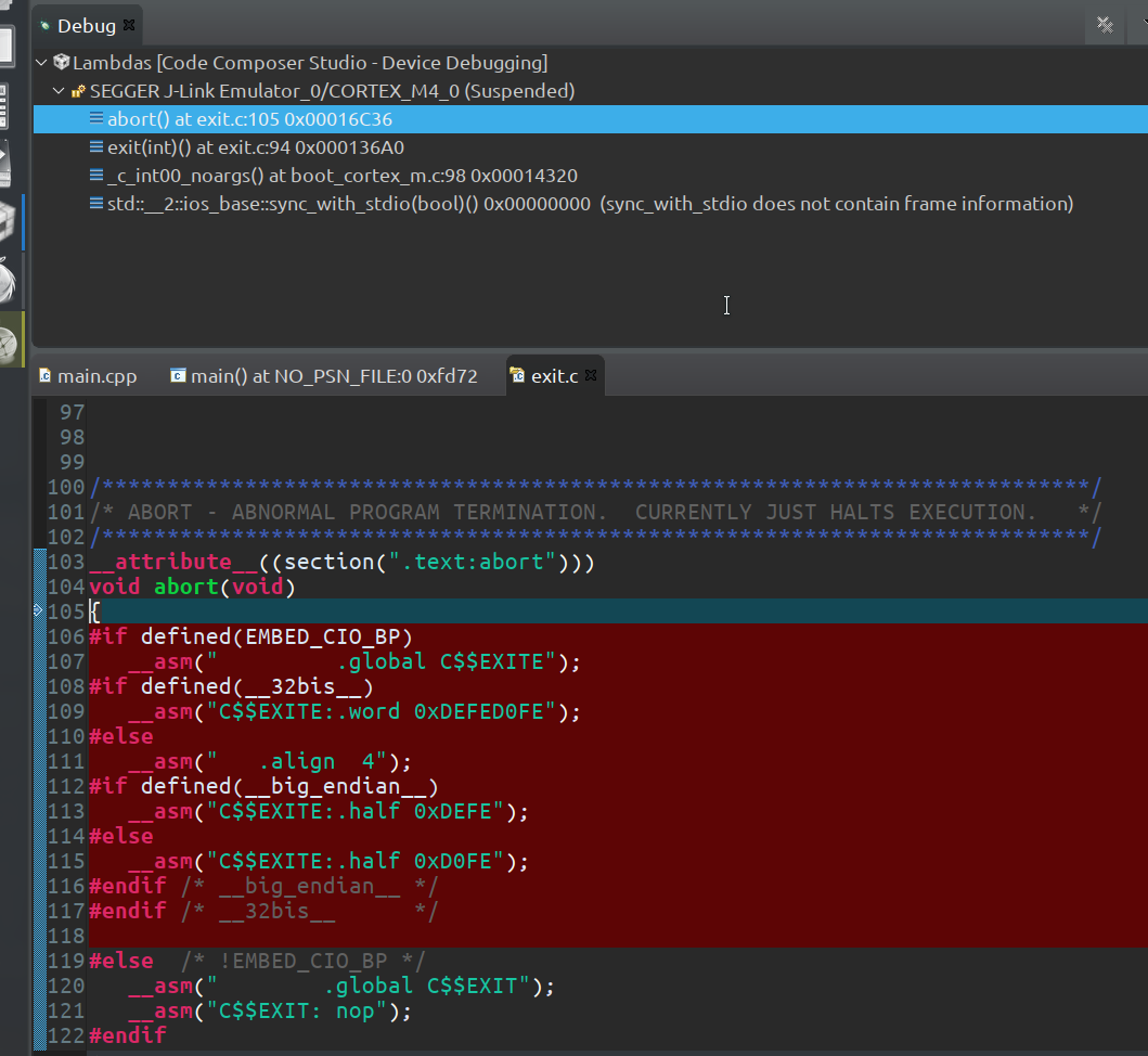

It compiles properly, but when I try to debug it I get:

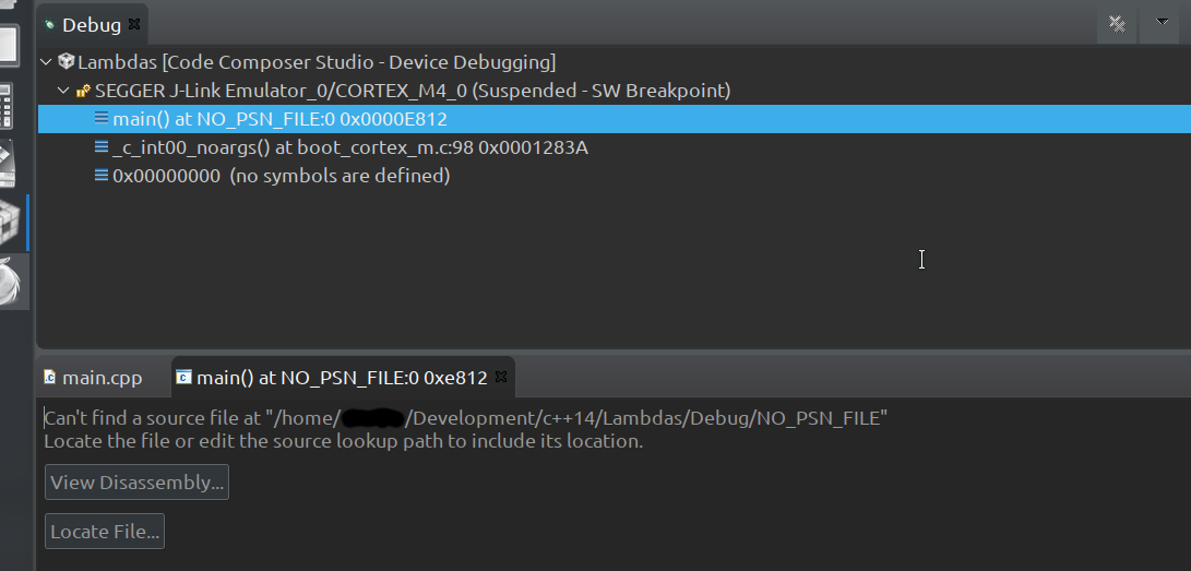

  • The fact that the debugging information says there is a file named "NO_PSN_FILE" is a bug. This bug does not have a bug tracking number. It should be fixed in the next LTS release. For now, just ignore that message.
    If you hit the "run" button after reaching the first breakpoint in main, does the program then run properly? If not, please describe to us exactly what you see.
  • After hitting RUN, abort() is called:
  • From the stack, we can see that abort was not called while main is on the stack; the program thinks it ran normally, exited main, and the boot code called exit, which on this target always calls abort. So the problem is that you did not get any output when the pragma is defined inside main.

  • Well, it runs now. I tried removing support for RTTI (that I enabled for another test) and it worked. The funny thing is that I then re-enabled it and it still kept working. Finally, I set heap/stack to the original values 16K/2K, and it continues working fine:
    The message:
    Can't find a source file at "/home/pibe/Development/c++14/Lambdas/Debug/NO_PSN_FILE"
    Locate the file or edit the source lookup path to include its location.
    is still there though, and the debugger does not stop at the beginning of main(), I need to give it an step for that.
