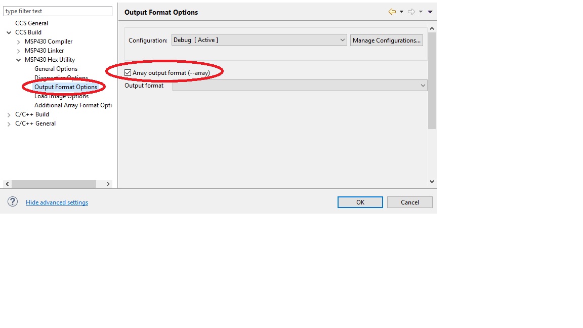

    In addition, what are the compiler/linker commands/key words to a constant array of characters into flash memory rather than ram.
    Use the --array option of the hex utility.  Note this is a new feature which is available only with the latest version 18.1.x.LTS.  You can add this step in your CCS project.  You have to enable the hex utility, then select the --array option.  See the screenshot below.

  • Ok I got the output file to work, thanks.
