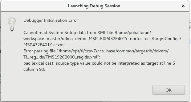

I am using CCS 7.4 on Linux (Centos). I was able to use CCS with debug session without problems for a long time until recently. Now when I create new workspace or add a new project to an existing workspace, then launch debug session, I always get the following error. I can still work with old projects but can't create new project or workspace. The two files mentioned in the error message are attached.

  • Attach CCS error message.
    Have you been working with the same target the whole time?
    Basically, for the old projects (that still work) and the new projects (that don't), are you using the same target configuration?

  • Hi, Ki
    Yes I have been using the same target and the same configuration.
    Qiuping
  • That is odd. Can you attach the TMS192C2000_regids.xml file to this thread?

  • Qiuping,
    Sorry for the delayed response. I see no issue with the xml file you provided. It looks fine and I dropped it into CCS 7.4 of my linux laptop and was able to start a debug session without isuse.
    Can you try some of the following:
    -Use a clean new workspace folder
    -Delete the MSP432E401Y.ccxm file and create a new one
    -Delete all launch and target cache files: processors.wiki.ti.com/.../Troubleshooting_CCSv7
    let me know the result of these attemps
