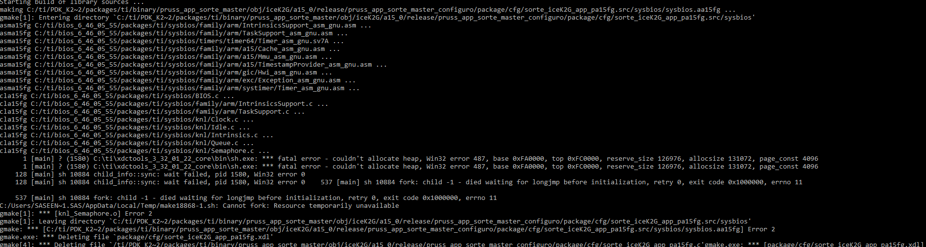

I am compiling pdk_k2g_1_0_6. I am following this link to build the pdk : http://processors.wiki.ti.com/index.php/Rebuilding_The_PDK
How to resolve this ?

    There is no spaces in pdk directory name. I am compiling from C:\ti\pdk_k2g_1_0_6\packages folder. Still the error persists. We were able to compile pdk_k2g_1_0_8 without any issues. But we need pdk_k2g_1_0_6.

     3 [main] sh 5196 C:\ti\xdctools_3_32_01_22_core\bin\sh.exe: *** fatal error - fork: can't reserve memory for stack 0x2BC770 - 0x2C0000, Win32 error 487

    Can you make sure there is no other shell in your environment (e.g. cygwin, MKS, etc.). Note: I've seen a different shell instead of git sometimes also. The issue is that shell is getting used instead.

    We tried restarting the system, then ran gmake. It will run to some point, then this error will come. Is it is because of any memory issue?. Here in that error message, we could see that, the reserve_size is less that allocsize. Could we reset or increase any related memory?. (This is just a thought process).
  • We've seen issue with other shells that cache information that will cause errors like this. So after a reboot, it seems to work, but then the other shell does something (unrelated) and "bang" the build breaks. Can you do a "set" from a command line and attach the output? Also, which OS (and version) are you using?

    We are using Windows 10.
    This is the output of set command in the same window.
    C:\ti\PDK_K2~1\packages>set

  • The bolded text looks strange. Can you correct that?
    XDCPATH=../../..;C:/ti/xdctools_3_32_01_22_core/packages;/ti/PDK_K2~1/packages/.;C:/ti/edma3_lld_2_12_04_28/packages;C:/ti/bios_6_46_05_55/packages;C:/ti/ipc_3_46_00_02/packages;C:/ti/ndk_2_25_01_11/packages;C:/ti/uia_2_00_06_52/packages
  • Did this get resolved?
    Todd
  • We set up the pdk in a new system, where there is no newer version of pdk exists. Here we didn't faced any issue like this.
