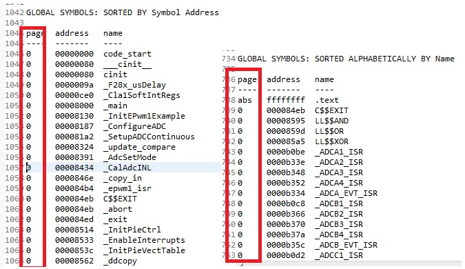

1) How to delete the "page" in *.map as below:
2) How to show the structure member in *.xml.
Is it in the compiler configuration? Several compilers are tried, but failed.
Thanks a lot.
Br, Jordan
    Unfortunately, there is no way to do that.
