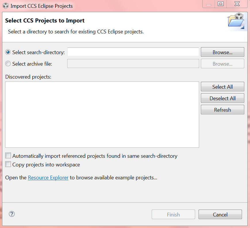

I want to use TMS320F2808 that integrate with TYPHOON HIL 400.
Im using MATLAB 2016b and CCS V6 in order to download the program into f2808.
The problem is, i cannot import the project file that i build in Matlab.
The folder of CCS has been created by Matlab, but it seems like the CCS cannot find the file.
I have done all the setting in configuration parameter in Matlab.
But when i try to import the project, it shows nothing.
Hoping to find the solution. Thank you.

    What is the format of this project generated by Matlab? What is inside the generated "CCS" folder?
    How did you import the project?
    Any screenshots would be very helpful

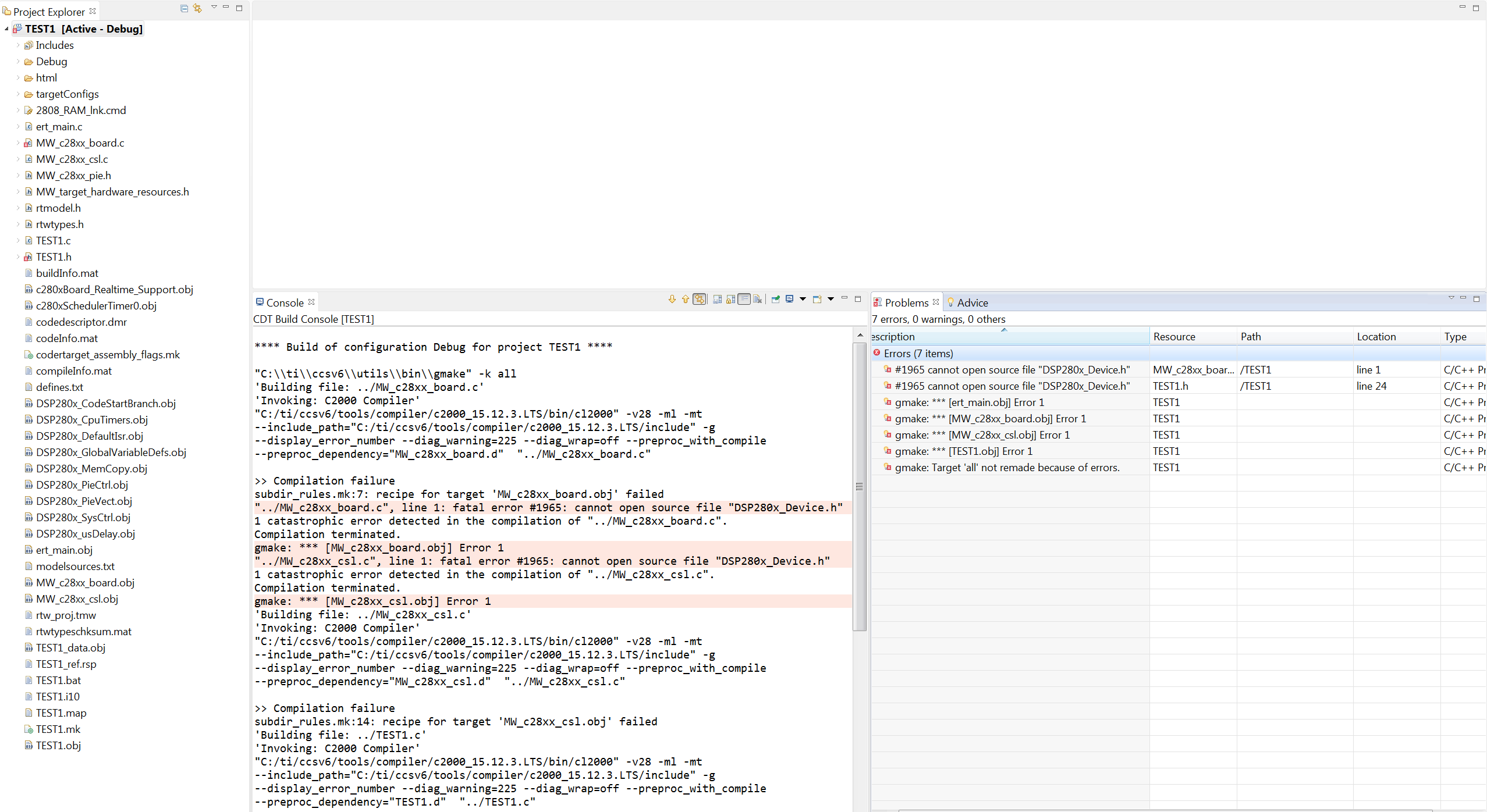

    so i need to open new ccs project with empty project and select the import source as file system and choose the TEST1 folder.
    After that, i try to build project of TEST1 but the compilation is fail. The error show as per attach.

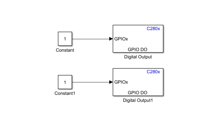

  • hi,
    this is the simulink model that i want to upload into f2808,
    i want to try the simple test but still i got so many errors

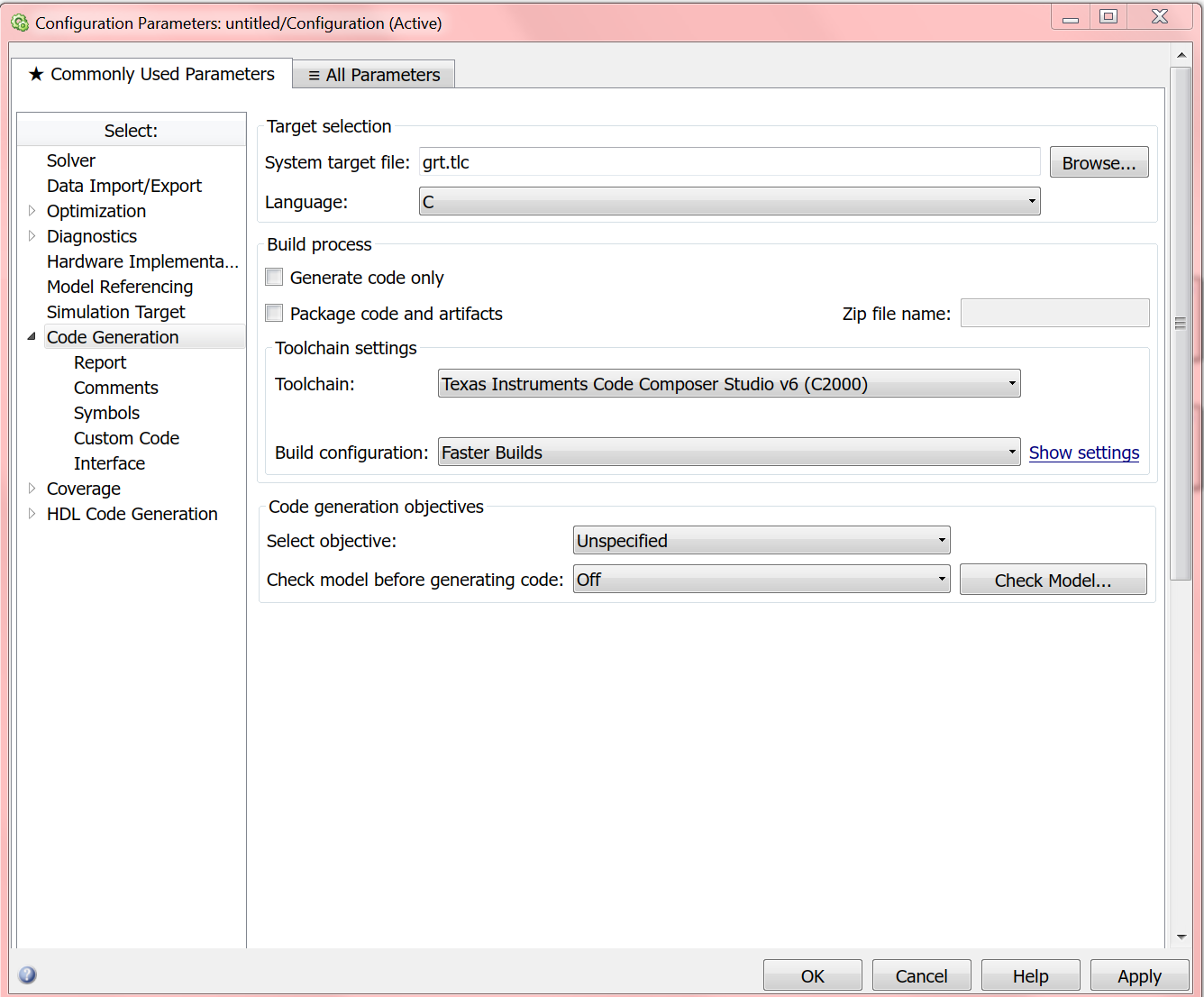

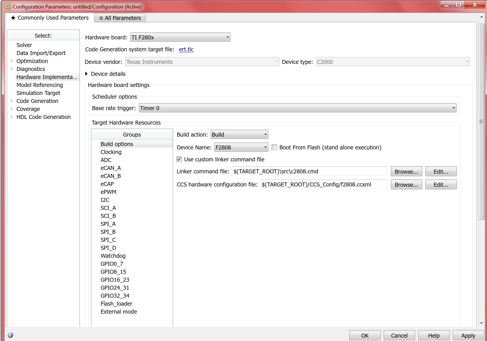

    i also attach the configuration that i set in matlab.
    hoping to have suggestion from u.
    thank you.
    SIMULINK MODEL
    CONFIGURATION PARAMETER

  •  hi,

  • hi,
    i try to check the setup in matlab which i think related with the 'gmake' error in ccs.
    In configuration setup, i cannot choose ccsv6 which it seems like matlab cannot detect the ccv6.
    maybe there have setup or something that i missed.
    Hoping to have a reply from u.
    Thank you.
