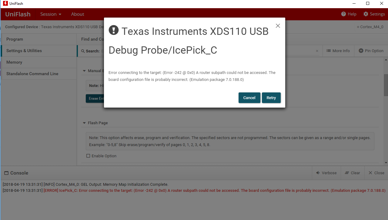

In our application, we lock down all the debug interfaces so that the binary firmware, and other sensitive information, stored in on-chip flash cannot be read out.
On cc13xx, we can (must) perform a "Forced Mass Erase" on the device in SmartRF Flasher 2. This application doesn't support cc13x2 yet. UniFlash does support cc13x2, but to my knowledge not a Forced Mass Erase on said device.
Of course, I can temporarily disable the read-out protection, but that is but a temporary solution.
Can you add "Forced Mass Erase" support to UniFlash (including the command line tools)? Alternatively (actually preferred), add cc13x2 support to SmartRF Flasher 2?
