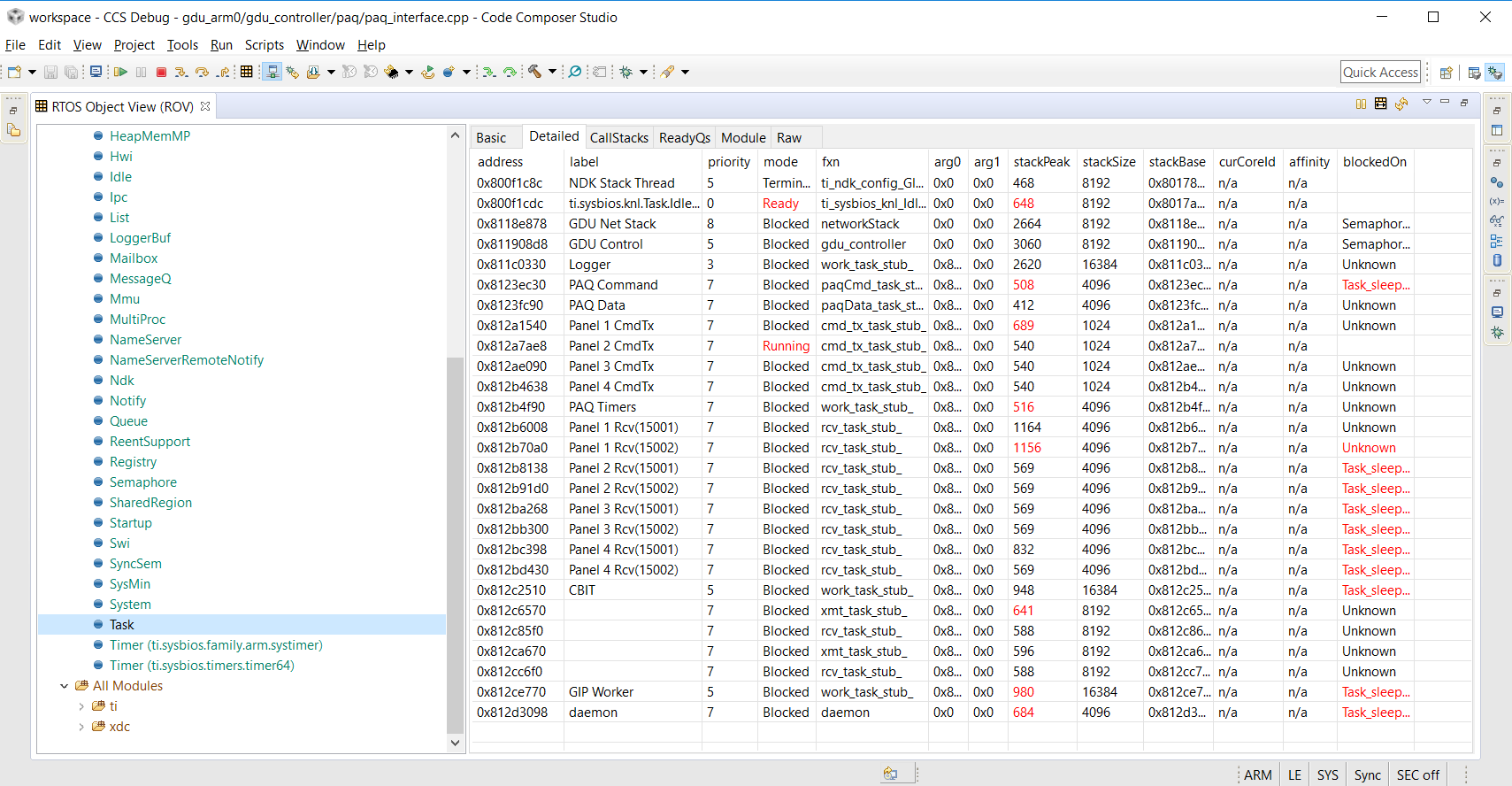

When I view the Detailed tab of the ROV Task very often all data is display in red. What is that telling me? I know in other views, and at other times in Task->Detailed only items that have changed are in shown in Red. When I see everything as red I'm not sure how to interpreted it. It is giving me a bad feeling.

Above: While running - boring as nothing is shown..

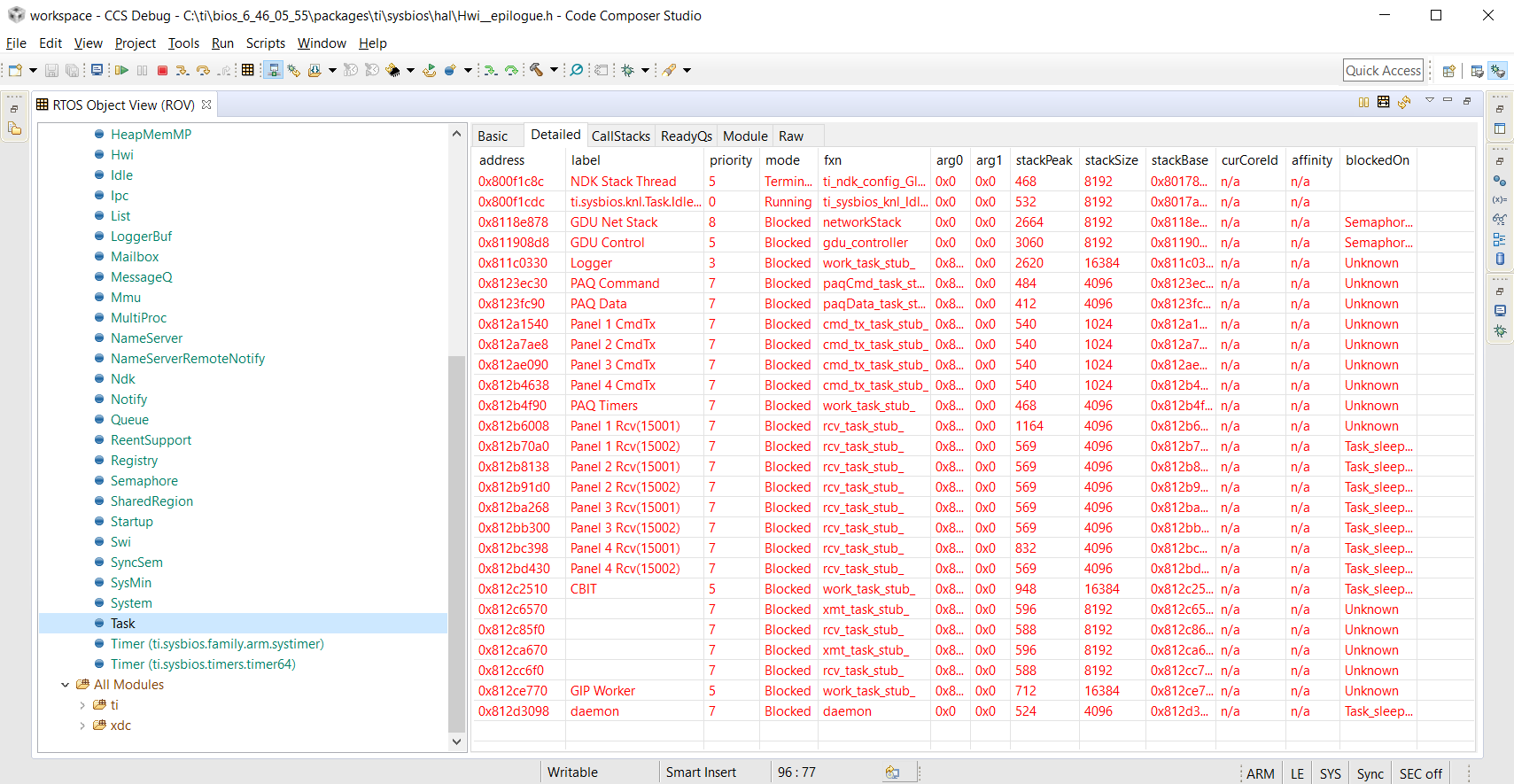

After letting the project run, I hit the Suspend button and captured the above. Application is running. All my tasks have been created.
Above I've hit a break point. I guess the above is what I was expecting to see most of the time. A handful of specific things displayed in red indicating change.
Above I single stepped. Now a lot of the info is blank, specifically the blockedOn that was shown before single stepping.
Now I let it run again to the same break point. Below is the next capture I get when I hit the break point again:
The above looks 'not good'. It is this that I am looking for an explanation of.

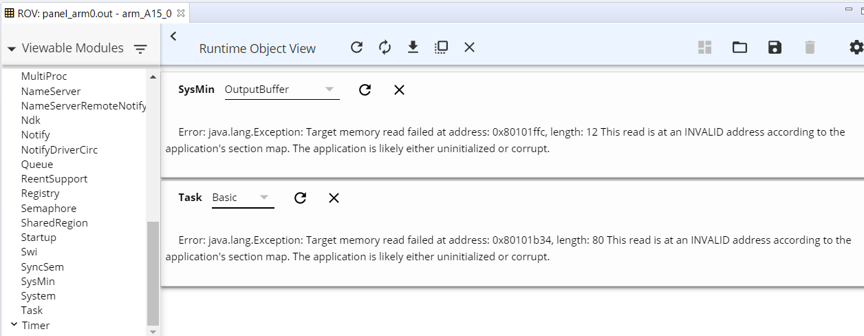

Thanks for the additional information. Unfortunitely we've never been able to get the new ROV working although I just tried it again and it seemed to get further along than I remember from the last time I tried it back last early Fall:

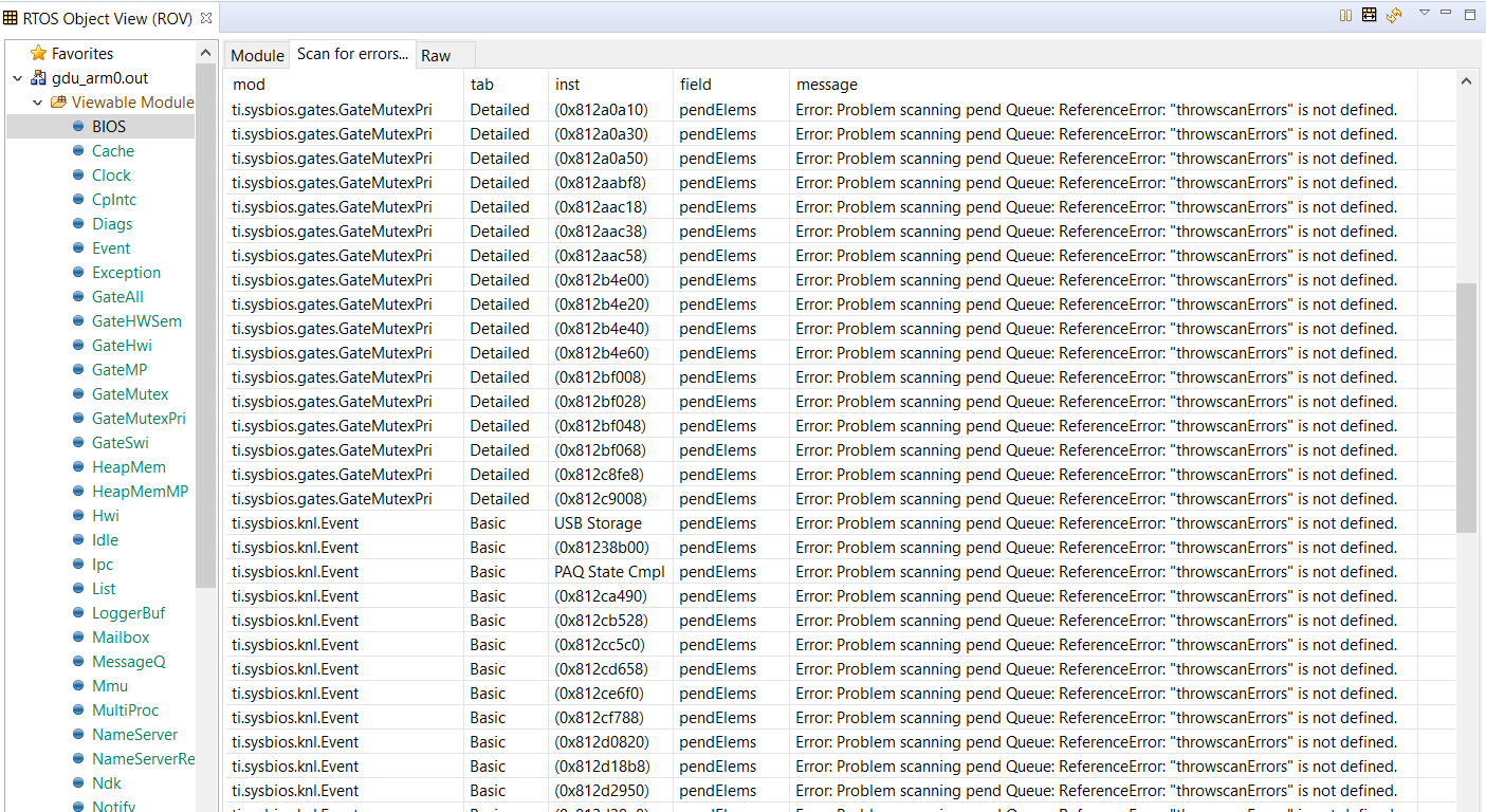

In regard to the "Scan for errors", maybe you have found a clue. Where can I find documentation on "Scan for errors" to learn what it does for me? I ran it and it is showing many errors but I do not know what they mean:
All the tasks were displayed in RED when I went to the above tab.
If I suspend and step until I am not getting all tasks in RED , then the Scan gives:
I am using GateMutexPri throughout my code.

The error you found in the "Scan for errors" is an existing bug in the xdc tools used by your project.
To fix this:
- Open the file C:\ti\xdctools_3_32_02_25_core\packages\xdc\rov\Program.xs
- at line 645, fix the invalid object name.
Where it reads:
if (throwscanErrors) {
change to
if (throwScanErrors) {
Save the file and re-run the Scan for Errors. It should display the exact error explanations.

What error did I find? Are you saying the varying results when I do a scan for error is the problem it self or the data reported is the error? Is the bug related to the RED display under Tasks? I ask because there seemed to be a distinct correlation between Scan for Errors listing error and all RED in tasks. If Scan for Errors reported none, than tasks were not all in RED. At least for the few iterations I tested.

Mike Dannhardt said:What error did I find
The data reported. The error I mentioned is shown in the message tab of the "Scan for errors" results, and the giveaway is the text "ReferenceError: "throwscanErrors" is not defined".
This will only repair the problem with this report, but the original problem with your system persists.
Mike Dannhardt said:I'd reluctant to change XDC tools.
At your development stage, I would be reluctant as well. Let's hope the error reporting gives additional insights about the system problem and we move from there.
