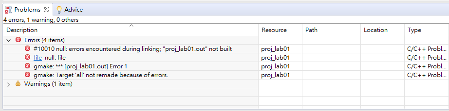

But when i use one of the example project to program into controlCARD, it show this error message.
Can anyone help me to solve this problem?
    This error is coming at project build time even prior to programming. Could you let us know which example project you are trying to build? Is it one from ControlSuite? If so, which one exactly?
    Also please copy the full output from the CCS build console to a text file and attach it here.

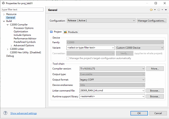

  • Hi,thank you for your reply. I have solved this problem by myself.
    The reason why i can't program the project into the controlCARD is that i select the wrong setting.
    After i modify the setting below, i can success program.
    I am very appreciating to your reply. Thank you.
