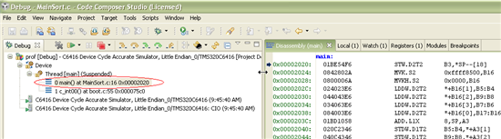

b) However, after code is loaded to device, if I go to menu View --> Disassembly, the disassembly window is still empty. I have enabled show source (right click in disassembly window), but did not find any other option that might be relevant.
Do you have any idea about what am I missing in order to view code in disassembly window?

One thing to check is if you have the correct Debug context. If you do not, you views will not show any content.
in the first screenshot, I see disassembly content because I have selected the correct context in the stack. In the second one, I am a node above and it does not show any content in the disassembly view.
In this screenshot, the disassembly view is blank:
