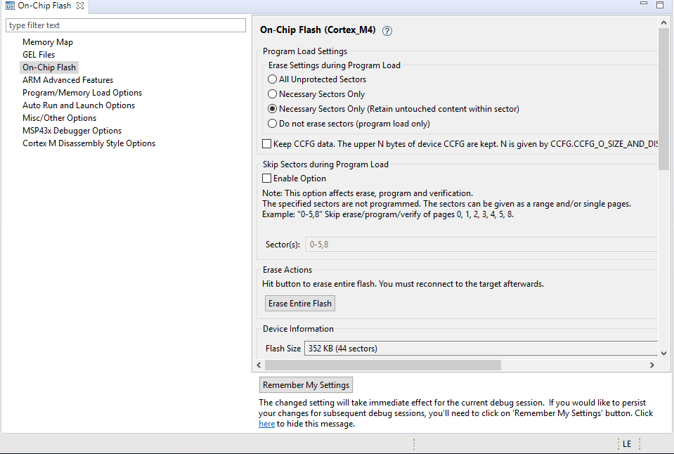

    3. Can you provide a screenshot of the available On-Chip Flash settings for your device? I want to see if the "FlashPageToggle" option is available in your case. You can find the On-Chip Flash settings by launching a debug session for your configuration, and going to 'Tools -> On-Chip Flash'.
    This is how it looks for me on CCS8.0.0.00016 with the latest CC13xx/CC26xx Device Support update (v3.10.1.00):

    3. Attached.
    All of the above were true -- but when I clicked on "CC13xx/CC26xx Device Support" and hit "Update", the latest (apparently) was downloaded -- 3.10.2.00 (release date 2018-04-23). Restarting CCS and trying again, it worked fine.
    Screenshot for #3 was taken after the problem was fixed and the device supported was updated. Not sure if it helps, still.
