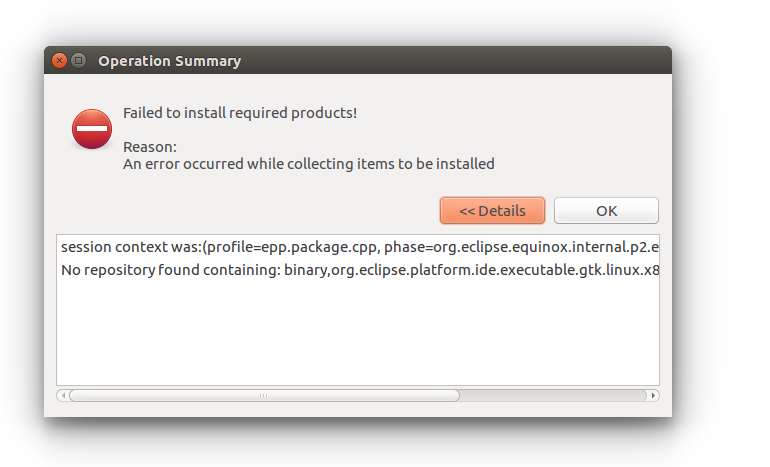

I cannot update or import to Code Composer Studio downloaded projects, when I try Help->Check for Updates
When I try to import the hello world example I get:

Running it with sudo fixed the problem, didn't had to go through the work around (which I had tried previously and it did not worked)
I think this sentence:
"if you installed CCS as the superuser (sudo), you will have to run CCS at the same privilege level to install updates"
Should be on the CCS linux instructions,
