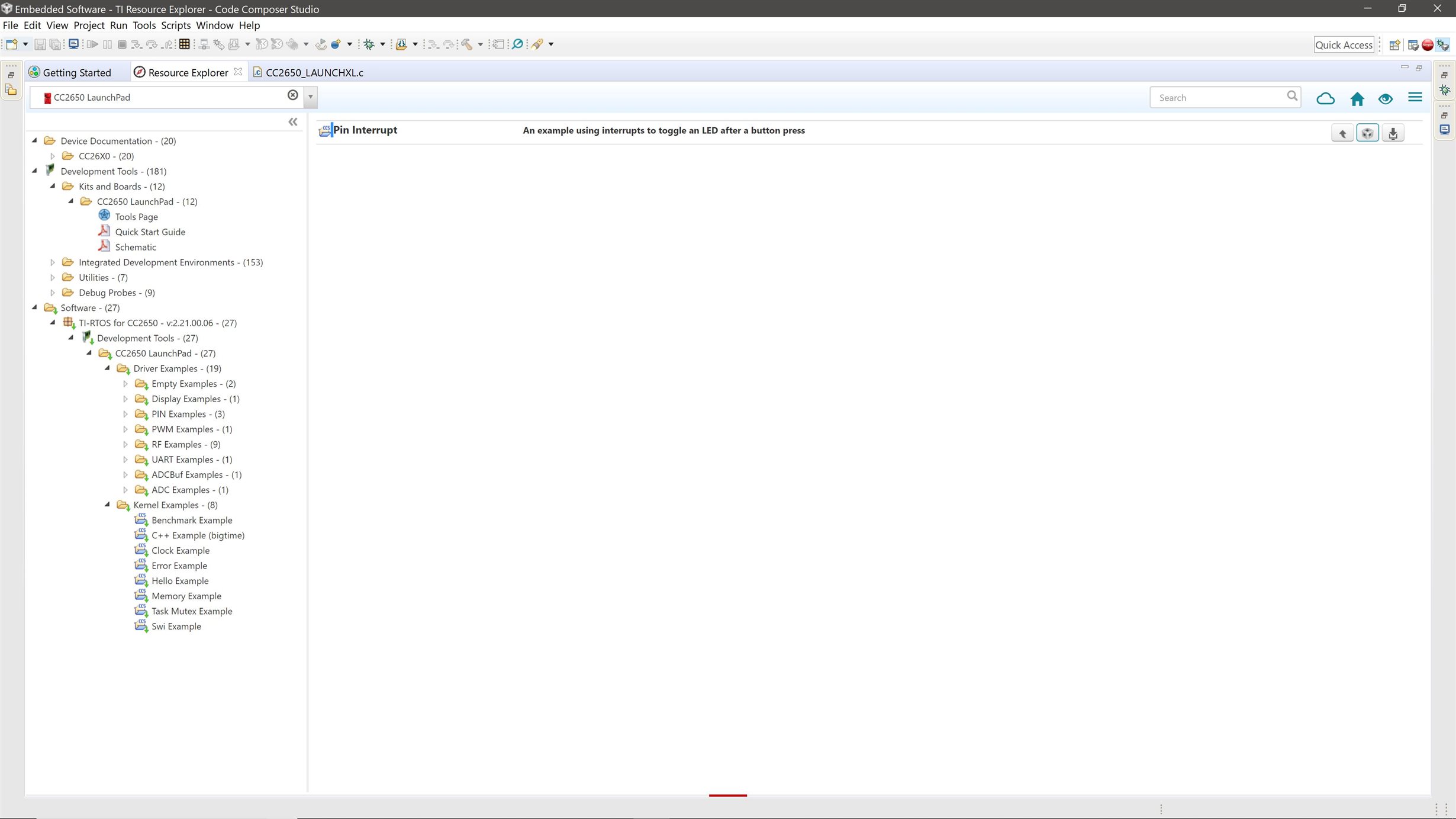

Hello ...first time user of TI software tools.
1. Downloaded latest CCS v8 and installed it on my computer. Downloaded and installed TI-RTOS as well.
2. Went through the Introduction and as suggested also downloaded and installed the BLE SDK 2.2.2.
3. Have I downloaded all necessary software modules I need to start my project?
Problems (2 of them):
1. I can't see the BLE SDK folder in Project Explorer on the left but can see the RTOS folder and its subdirectories (see below). How can I resolve this problem?
2. I tried to run one of the example files (by clicking the "Build" hammer button) and got a whole bunch of compilation errors. See pic below and inserted compilation log file. I was under the impression that all will run smoothly as the documentation said. What can I do to resolve these errors? I suspect maybe there's one root cause for all of them, but I have no proof to back up my suspicions.

    1) The BLE-Stack on CC2650 is not supported in CCS Resource Explorer. Please install the BLE-Stack locally and use the import wizart to import these projects (link: www.ti.com/.../ble-stack ). To import the projects to CCS: Project -> Import CCS Project.
    What development environment are you using? In general the BLE-Stack for CC2650 only supports Windows.
    2) What compiler are you using?
    Can you try importing the pin example from Resource Explorer Classic?
  • Hi Marie:
    1.  I'm using Windows 10 PRO and by Resource Explorer Classic, do you mean "CCS Simple"?
    2. I'm using the latest CCS v8 for windows.
    3. I installed the BLE-Stack locally but still doesn't show up in explorer. See attachment below.
    4. When the compiler says Build FInished", does it mean that the program is loaded into the processor flash and ready for execution? If not, how can I make it build, load and run the program in one command or click?
    David
  • Hi David,
    1) No. Open the View menu and select Resource Explorer Classic.
    3) BLE-Stack 2.2.2 is not supported in Resource Explorer. You can import BLE-Stack project to CCS by opening the Project menu and selecting Import CCS Project...
    4) No it's not programmed as part of the build process. If you press the bug symbol (Debug) the project will be built and programmed and a debugging session will begin.
