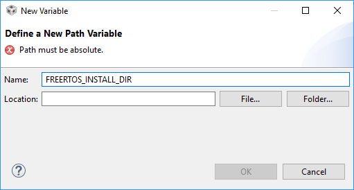

  • I created a folder named libraries and I added FreeRTOS and SKD Files in the parent folder. I've changed FreeRTOS and SDK paths but now I've found if I use a absolute path it is working ok but If I use variables like "FREERTOS_INSTALL_DIR=${PARENT_LOC}/LIBRARIES/FreeRTOSv10.0.0" I get this error: "Errors occurred during the build.
    Errors running builder 'CDT Builder' on project 'freertos_builds_MSP_EXP432P401R_release_ccs'.
    URI is not absolute"
  • Antonio,
    For the example FreeRTOS projects, the variable FREERTOS_INSTALL_DIR needs to be defined as both a Linked Resource Path variable and as a build variable. This is because there are source files linked with paths relative to that variable, and the variable is also used in compiler include options. CCS simplifies the process by letting you define it in just one place (under Window->Preferences->Code Composer Studio->Build->Variables) and it is then set as both a Linked Resource path variable and as a Build variable in the example projects.
    For it to be accepted as a Linked Resource Path variable, it needs to be defined as an absolute path. To verify this, if you try to create a new Linked Resource path variable (from Window->Preferences->General->Workspace->Linked Resources) you will notice a message like this.
    If your custom project is created such that there are no linked resources (ie all source files are physically copied inside the project folder) then the variable would not need to be defined as a Linked Resource Path variable. However for the way the example projects are currently designed this is required to be an absolute path.
    Hope this helps clarify!
