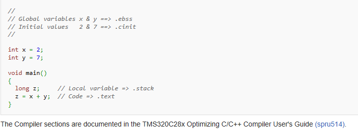

From the Wiki of C28x Compiler, the below content can be seen:
But i do not know why x&y are in the .ebss seciton, in my understanding, x&y should be in the .data section because they are initialized global variables.
Thank you in advance.
